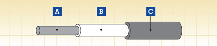

       A.µ¼Ìå                     B.¾øÔµ                 C.»¤Ì×

µçÀ½ṹ
µ¼Ìå
·ûºÏHD383 (IEC 60228) class 5 ±ê×¼µÄÈáÈí¶ÆÎýÍË»ðÍ­Ë¿
¾øÔµ
·ûºÏEN 50264-1 (EI 101 ÖÁ EI 104) ±ê×¼µÄµÍÑÌÎÞ±µ¯ÐÔ»¯ºÏÎï
»¤Ì×
·ûºÏEN 50264-1 (EM 101 ÖÁ EM 104) ±ê×¼µÄµÍÑÌÎÞ±µ¯ÐÔ»¯ºÏÎï
