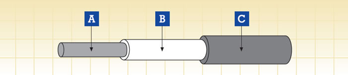

                                                                A.µ¼Ìå           B.¾øÔµ        C.»¤Ì×
µçÀ½ṹ
µ¼Ìå
·ûºÏHD 383 (IEC 60228) class 5 ÈáÈí¶ÆÎýÍË»ðÍ­Ë¿
¾øÔµ
·ûºÏEN 50382-1 ±ê×¼µÄ¹èÏð½º(EI 111)
Í⻤Ì×
·ûºÏEN 50382-1 ±ê×¼µÍÑÌÎÞ±(LSZH) µ¯ÐÔ»¯ºÏÎï(EM 105, EM 106 »òEM 107)
