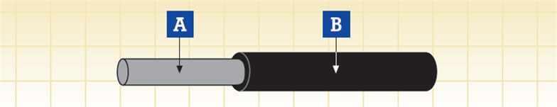

FIREROL FRL-MW-1SU/FRL-MW-3SU
                                                    A. µ¼Ìå                    B. ¾øÔµ
Ó¦ÓÃ
ÔÚÌú·ÔËÊä»ú³µµÄÄÚ²¿»òÍⲿ°²×°Ê±ÓÃ×÷µçÁ¦ºÍ¿ØÖƵçÀ£¬ÔÚÕâÖÖ»·¾³Ï°áÔ˺Ͱ²×°³É±¾ÊÇÐèÒª¿¼ÂǵĺÜÖØÒªÒòËØ¡£ÓÃÓÚ¿ØÖÆ£¬¸¨ÖúºÍÖ÷µç·½ÓÏßÈçÓÐÏßµçÊÓµõ´ø£¬¿ª¹ØºÍ¿ØÖÆÃæ°å£¬¼Ýʻ̨µÈ¡£
µçÀ½ṹ
µ¼Ìå
·ûºÏHD383 (IEC 60228) class 5 ±ê×¼µÄÈáÈí¶ÆÎýÍË»ðÍ­Ë¿
¾øÔµ
·ûºÏEN 50264-1 ±ê×¼ (EI 106 ÖÁ EI 109) µÄµÍÑÌÎÞ±µ¯ÐÔ»¯ºÏÎï
