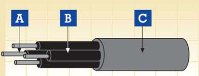

                                                 A.µ¼Ìå           B.¾øÔµ         C.»¤Ì×

µçÀ½ṹ
µ¼Ìå
·ûºÏHD383 (IEC 60228) class 5 ±ê×¼µÄÈáÈí¶ÆÎýÍË»ðÍ­Ë¿
¾øÔµ
·ûºÏEN 50264-1 (EM 101 ÖÁ EM 104) ±ê×¼µÄµÍÑÌÎÞ±(LSZH) µ¯ÐÔ»¯ºÏÎï
Í⻤Ì×
