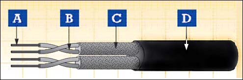

                                   A.µ¼Ìå         B.¾øÔµ           C.ÆÁ±Î          D.»¤Ì×
Ó¦ÓÃ
- ÔÚÌú·ÔËÊä»ú³µµÄÄÚ²¿»òÍⲿ°²×°Ê±ÓÃ×÷µçÁ¦ºÍ¿ØÖƵçÀ£¬ÔÚÕâÖÖ»·¾³Ï°áÔ˺Ͱ²×°³É±¾ÊÇÐèÒª¿¼ÂǵĺÜÖØÒªÒòËØ¡£
- ÓÃÓÚ¿ØÖÆ£¬¸¨ÖúºÍÖ÷µç·½ÓÏßÈçÓÐÏßµçÊÓµõ´ø£¬¿ª¹ØºÍ¿ØÖÆÃæ°å£¬¼Ýʻ̨µÈ¡£
µçÀ½ṹ
µ¼Ìå
·ûºÏEN 50306-2 ±ê×¼µÄ¶ÆÎýÍË»ðÍ­Ë¿
¾øÔµ
µÍÑÌÎÞ±(LSZH) ÌØÊ⻯ºÏÎï
×ÜÆÁ±Î
¶ÆÎýÍË»ðÍ­Ë¿
Ïß¶ÔÆÁ±Î
µ¥¶ÔÆÁ±ÎºÍ»¤Ìס£µ¥¶ÔÆÁ±Î·ûºÏEN 50306-3 ±ê×¼£¬»¤Ì×(S1, S2) ·ûºÏEN 50306-3 ±ê×¼
Ïß¶Ô±àÂë
·ûºÏEN 50306-4 Ïß¶Ô±êʶ
Í⻤Ì×
·ûºÏEN 50264-1 ¹æ¶¨µÄµÍÑÌÎÞ±(LSZH) ÌØÊ⻯ºÏÎï(S2, EM 101 - EM 104)
