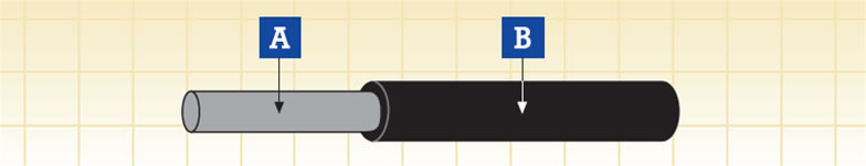

                                                         A. µ¼Ìå            B. ¾øÔµ
µçÀ½ṹ
µ¼Ìå
·ûºÏHD 383 (IEC60228) class 6 ±ê×¼µÄ³¬ÈáÈí¶ÆÎýÍË»ðÍ­Ë¿
¾øÔµ
·ûºÏEN 50382-1 ±ê×¼µÄ¹èÏð½º(EI 111)
