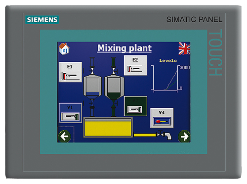

  • ¿ÉÒÔÖ±½Ó²Ù×÷¼à¿Ø»úÆ÷ºÍÉ豸µÄ´¥¿ØÊ½Ãæ°å
  • ¼´Ê¹Ãæ°åÔÚÎÞµç³ØµÄÇé¿öϱ»ÇжϵçÔ´£¬Ò²²»»á¶ªÊ§ÏûÏ¢»º³åÆ÷ÖеÄÊý¾Ý
  • µãÕóͼÐÎʽ TFT ÏÔʾÆ÷ 256 É«£¬´ø´¥ÃþÆÁ

ÓÉÓÚÆäʵÓõŦÄܺÍÇ¿´óµÄÓû§´æ´¢Æ÷£¬TP 277 6" ´¥ÃþÃæ°å¿ÉÓÃÓÚÈκÎÏÖ³¡ÐèÒª²Ù×÷Ô±¿ØÖÆºÍ¼à¿Ø»úÆ÷ºÍÉ豸µÄµØ·½-ÎÞÂÛÊÇÔÚÉú²ú×Ô¶¯»¯¡¢¹ý³Ì×Ô¶¯»¯»¹ÊÇÔÚ½¨ÖþÉèÊ©×Ô¶¯»¯ÖС£ TP 277 6" ÌṩÓÐÒ»¸ö 256-É« TFTÏÔʾÆ÷¡£ ¸ÃÉ豸ÅäÓÐÒ»¸ö¼¯³Éʽ PROFINET I/O ½Ó¿Ú£¬ÒÔ±ã½øÒ»²½ÔöÇ¿Áé»îÐÔ¡£ ÁíÍâÒ»¸öÌØµã¾ÍÊDZêÅäµÄ·ÇÒ×ʧ±¨ÎÄ»º³åÇø£¬ËüÎÞÐ豸ÓÃµç³Ø¼´¿É½«±¨Îij¤¾Ã´æ´¢¡£

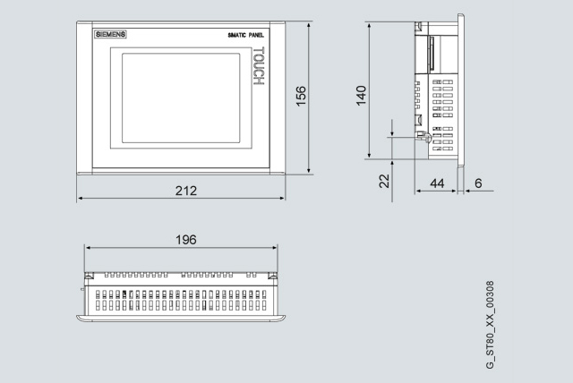

Dimensional drawings
ËùÓгߴçÒÔ mm Ϊµ¥Î»£¬Îó²î ± 1 mm¡£
