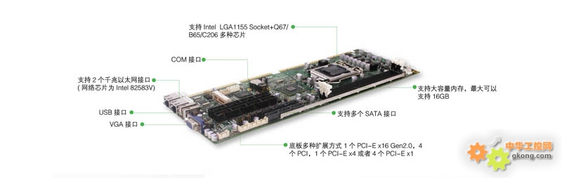

²úÆ·Ãû³Æ£º Æí·É¸ßÐÔÄÜÈ«³¤¿¨¹¤ÒµÖ÷°å
ÐÍ ºÅ£º PRA-FSC-Q67E
¹¤Òµ×Ô¶¯»¯Ö÷°åPRA-FSC-Q67EÊDzÉÓÃIntel Q67/B65/C206¸ßËÙоƬ×éµÄPICMG 1.3 ¹¤Òµ¼¶È«³¤¿¨¸ßÐÔÄܹ¤ÒµÖ÷°å£¬´îÔØÊг¡ÉÏÖ÷Á÷µÄIntel µÚ¶þ´úCore i7/ i5/ i3/Pentium/Sandy Bridge»òÕßE3-12xxϵÁÐÖÐÑë´¦ÀíÆ÷£¬¿á¦ÀíÆ÷ÊÇʱϺÜÏȽøµÄ´¦ÀíÆ÷£¬Äܹ»Âú×㹤ҵ×Ô¶¯»¯Ö÷°åÓ¦Óù¤¿Ø»úÖ÷°åµÄ¸÷ÖÖÐèÇó¡£ÕûºÏIntel HD »æÍ¼¼¼Êõ¡£Ö§³ÖÐÂÒ»´úµÄ¸ßËÙ´«Êä¼¼ÊõSATA 6Gb/sµÈ¡£°åÔØ2¸öIntel 82583VǧÕ×ÍøÂ·¿Ú£»Ö§³Ö1066/1333MHz¸ß´ø¿í˫ͨµÀDDRIIIÄڴ棬ÌṩÁ½ÌõDIMM²å²Û£¬×î´óÈÝÁ¿¿É´ï16G£»Í¬Ê±ÓµÓзḻµÄI/O£¬´æ´¢£¬À©Õ¹½Ó¿Ú¡£Æä¸ßЧÄܸßËÙµÄÌØÐÔÊʺϹ¤Òµ¿ØÖÆ£¬ÊýÖµ¼à¿ØÂ¼Ïñƽ̨£¬¹¤Òµ×Ô¶¯»¯É豸¹¤¿Ø»úÖ÷°åµÈÓ¦Óá£
²úÆ·ÌØÐÔ£º
¿á¤ÒµÖ÷°å»ùÓÚIntelµÚ¶þ´úCore i7¡¢Core i5¡¢Core i3/Pentium/Sandy Bridge/ Xeon E3-12xxϵÁÐÖÐÑë´¦ÀíÆ÷¡£
²ÉÓÃIntel LGA1155 Socket+Q67/B65/C206¡£
Ö§³Ö2¸öǧÕ×ÒÔÌ«Íø½Ó¿Ú(ÍøÂçоƬΪIntel 82583V)µÄ¸ßÐÔÄܹ¤ÒµÖ÷°å¡£
2¸ö240Pin 1066/1333 MHz DDRIII DIMM²å²Û£¬×î´óÖ§³Ö16GBµÄ¸ßÐÔÄܹ¤ÒµÖ÷°å¡£
8¸öRS-232½Ó¿Ú£¬ÆäÖÐÓÐÒ»¸öÖ§³ÖRS-232ºÍRS-485¡£
8¸öUSB2.0½Ó¿Ú¡£
6¸öSATAII£¬×î¸ßÖ§³Ö6Gb/s¡£
´Ë¹¤¿Ø»úÖ÷°åµ×°å¿ÉÀ©Õ¹1¸öPCI-E x16 Gen2.0£¬4¸öPCI£¬1¸öPCI-E x4»òÕß4¸öPCI-E x1¡£
Ö§³Ö8·GPIOÊäÈ룬8·GPIOÊä³ö¡£
