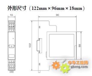

¶þ¡¢WS9050Èȵç×èÈ«¸ôÀëÐźŵ÷ÀíÆ÷µÄ²úÆ·ÍâÐÎͼ
