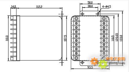

Èý¡¢FPPF¹¦ÂÊÒòÊý±äËÍÆ÷µÄ²úÆ·ÍâÐÎͼչʾ

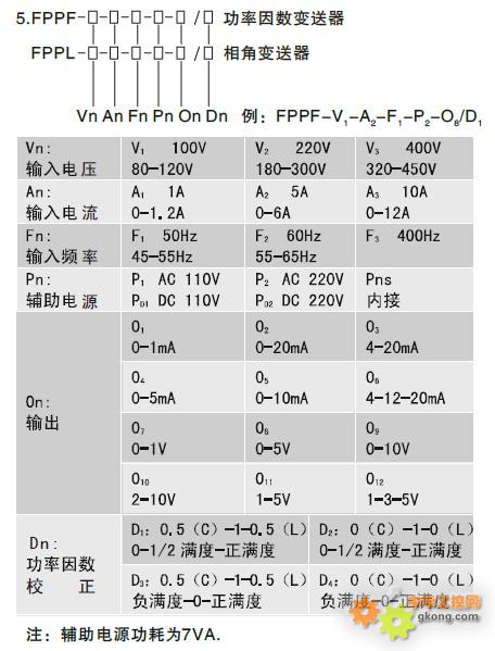

ËÄ¡¢²úÆ·Ñ¡ÐÍͼÒÔ¼°Ñ¡ÐÍʵÀý
ÐͺţºFPPF-V1-A2-F1-P2-O3/D1
ÊäÈë:0~100Vac,0~5Aac
Êä³ö:4~20mAdc
¸¨ÖúµçÔ´:AC220V
ÃèÊö£º´Ë²úƷΪ0~100Vac, 0~5AacÊäÈ룬±äËÍÊä³ö4~20mAdc,¸¨ÖúµçԴΪAC220V¡£
