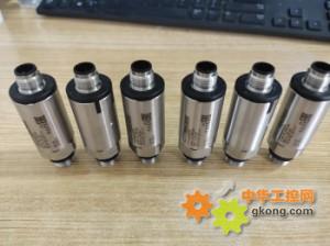

²úÆ·Ãû³Æ£º ÈðÊ¿¸»°ÍHUBAѹÁ¦´«¸ÐÆ÷511.941003742
ÐÍ ºÅ£º 511
ÖÊÁ¿ÀíÄî
ÈðÊ¿¸»°Í¹«Ë¾(Huba Control AG)ÔçÔÚ1995 Äê¾Íͨ¹ýÁ˹ú¼ÊÖÊÁ¿¹ÜÀí±ê×¼ÌåϵISO9001 µÄÈÏÖ¤.ÏÖÔÚÓÖ»ñÈ¡Á˹ú¼ÊÆû³µ¹¤Òµ±ê×¼ISO/TS 16949.ÎÒÃÇÔ±¹¤µÄÖÊÁ¿ÀíÄîÊdzÖÐø²»¶ÏµØÌá¸ß×Ô¼ºµÄ¼¼ÊõˮƽºÍ¹¤×÷ÖÊÁ¿Å¬Á¦²»³öÈκβî´í.ÈðÊ¿¸»°Í¹«Ë¾(Huba Control AG)Éú²úÖÆÔ첿ÃŵÄÖ°ÔðÊÇ×°Åä, µ÷ÊÔºÍУÕýѹÁ¦´«¸ÐÆ÷ºÍѹÁ¦¿ª¹Ø. Ã¿µÀ¹¤ÐòµÄÉú²ú¶¼±»ÓÅ»¯µ½×´Ì¬. ÎÒÃÇÉú²ú¹ý³ÌÖйؼüÐÔµÄÇ¿ÏîÊÇÎÒÃǼÝÔ¦¸´ÔÓµÄ×Ô¶¯»¯Éú²úÏßµÄÄÜÁ¦ºÍ¾­Ñé. °üÀ¨È«×Ô¶¯Ñ¹Á¦Ð£Õý. ËùÓÐÈðÊ¿¸»°Í¹«Ë¾(Huba Control AG)µÄ²úÆ·½öÔÚÈðÊ¿±¾ÍÁÉè¼Æ,ÖÆÔì×°ÅäºÍµ÷ÊÔ.
²úÆ·ÌØµã
ÓÅÔ½µÄµç´Å¼æÈÝ£¨EMC£©
µçÔ´·´Ïà±£»¤£¬¾²µç±£»¤500VDC
¹ý½éÖÊֹͣϵͳ£¨±¬ÆÆË¨£©
Quickon¿ìËÙÁ¬½á£¬½ÚÊ¡60%ÅäÏßʱ¼äUL¡¢CSA¡¢CEÈÏÖ¤
ÃÜ·â²ÄÖÊ£ºÑ¡Ïî²ÄÁÏFPM£¬NBR£¬»òÆäËü¿Í»§ÒªÇó
¶¯Ì¬ÏìÓ¦£º¿ÉÊʺϾ²Ì¬ºÍ¶¯Ì¬µÄ²âÁ¿£¬ÏìӦʱ¼ä<2ms£¬Í¨³£Îª1ms
µäÐÍÓ¦ÓÃ
Õæ¿ÕÉ豸£¬¿Õѹ»ú£¬ÓÍѹÉ豸µÈ
ÈðÊ¿¸»°ÍHUBAѹÁ¦´«¸ÐÆ÷511.941003742¼¼Êõ²ÎÊý
Ïà¶ÔѹÁ¦ -1¡«600bar
0¡«25bar
¹ýÔØÑ¹Á¦ 3.0×ÂúÁ¿³Ì£¨ÔÚÁ¿³ÌΪ-1¡«4bar£©
2.5×ÂúÁ¿³Ì£¨ÔÚÁ¿³ÌΪ6¡«400bar£©
2.0×ÂúÁ¿³Ì£¨ÔÚÁ¿³ÌΪ600bar£©
ÆÆÁÑѹÁ¦ 3.0×ÂúÁ¿³Ì£¨ÔÚÁ¿³ÌΪ-1¡«4bar£©
·À»¤µÈ¼¶ IP67
Íâ¿Ç²ÄÖÊ ²»Ðâ¸Ö1.4305£¨AISI 303£©
ζȷ¶Î§ -15¡æ¡«£«125¡æ
Ó¦ÓÃζÈ(ÃÜ·âÇé¿öϵĽéÖÊζÈ)
FPM -15¡«125¡æ£»NBR -25¡«85¡æ
FPM£¨spec£©-40¡«150¡æ
µç ѹ 8.0¡«33VDC,Êä³ö4-20mA
ÃÜ·â²ÄÖÊ Ñ¡Ïî²ÄÁÏFPM,NBR,»òÆäËü¿Í»§ÒªÇó
ÖØ Á¿ ÄÚÂÝÎÆ85¿Ë,ÍâÂÝÎÆ95¿Ë
¾« ¶È ¾«¶ÈÏßÐÔ,³ÙÖÍ,ºÍÖØ¸´ÐÔµÄ×ܺÍ<±0.3% FS
¶¯Ì¬ÏìÓ¦ ¿ÉÊʺϾ²Ì¬ºÍ¶¯Ì¬µÄ²âÁ¿
ÏìӦʱ¼ä<2ms,ͨ³£Îª1ms
