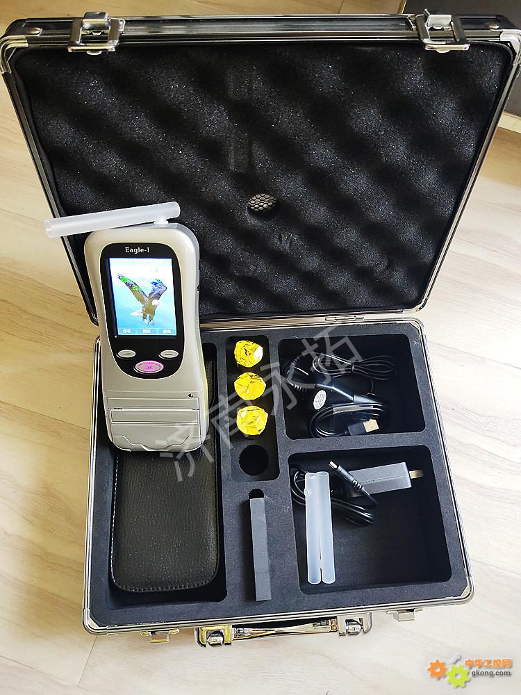

²úÆ·Ãû³Æ£º Eagle-1¾Æ¾«¼ì²âÒÇÌìÓ¥Ò»ºÅ
ÐÍ ºÅ£º Eagle-1
Ò»¡¢¿ªÏä¼ì²â
   ±ê×¼ÅäÖðüº¬ÓÐÒÔϲ¿¼þ£º
1¡¢Eagle-1Ö÷»ú¼°Æ¤Ì×                          1¸ö
2¡¢7.4V,2000mAhï®µç³Ø                         1¸ö
3¡¢Êеç³äµçÆ÷                                 1¸ö
4¡¢³µÔسäµçÆ÷                                 1¸ö
5¡¢Êý¾ÝÏß                                     1Ìõ
6¡¢´µ¹Ü                                       30¸ù
7¡¢ÈÈÃô´òÓ¡Ö½                                 4¾í
8¡¢ËµÃ÷Êé¡¢ºÏ¸ñÖ¤¡¢×°Ïäµ¥µÈ     1Ì×
²Ù×÷˵Ã÷
£¨1.£©³äµç
±¾»ú²ÉÓÿɳäï®Àë×Óµç³Ø£¬ÈÝÁ¿´ï2000mAh£¬ÄÚÖÃÓиßЧÉè¼ÆµÄ±£»¤°å¡£ÔÚµç³ØµçÁ¿²»×ãʱÐè¶Ô±¾ÒÇÆ÷³äµç£¨³äµçʱÒÇÆ÷ÎÞÐ迪»ú£©¡£
³äµçʱ½«³äµçÆ÷²åÈëÏàÓ¦µÄµçÔ´²å×ù£¨Êеç³äµçÆ÷½ÓÈëÊеç×ù¡¢³µÔسäµçÆ÷²åÈëÆû³µµãÑÌÆ÷×ù£©£¬°Ñ³äµçÆ÷Êä³ö¶Ë²åÈëÒÇÆ÷ÓÒ²à³äµçÊäÈë¿Ú£¬´Ëʱ×ó°´¼üÏÂÂÌɫָʾµÆµãÁÁ£¬Ö¸Ê¾µçÔ´ÊäÈëÕý³££¬ËæºóÓÒ°´¼üϺìɫָʾµÆµãÁÁ£¬´Ëʱ½øÈë³äµç״̬¡£Ò»°ãÇé¿ö»áÔÚ2~3СʱÄÚÓÒ°´¼üϺìɫָʾµÆ±äΪÂÌÉ«£¬Ö¸Ê¾³äµçÍê³É¡£³äµçÍê³ÉºóÇë°Î³ö³äµçÆ÷¡£
Èç²åÈëµçÔ´Êä³ö²åÍ·ÖÁÒÇÆ÷³äµç¶Ë¿Úºó£¬×ó²àÂÌɫָʾµÆ²»ÁÁ£¬±íʾ³äµçÆ÷ÎÞµçѹÊä³ö»òÊä³öÒì³££¬Çë¼ì²éÊеç»òµãÑÌÆ÷×ù¼°Æû³µµçƵµçѹÊÇ·ñÕý³£¡£Èç×ó²àÂÌɫָʾµÆµãÁÁ¶øÓÒ²àָʾµÆ²»ÁÁ£¬±íÃ÷µç³ØÄÚ²¿Î¶ȳ¬³ö0¡æ¡«45¡æµÄ·¶Î§£¬ÒÇÆ÷Äڵijäµç±£»¤µç·Æð×÷Ó㬲»¶Ôµç³Ø½øÐгäµç£»´ýζȻظ´µ½0¡æ¡«45¡æµÄ·¶Î§ÄÚ£¬×Ô¶¯»Ö¸´³äµç¡£
