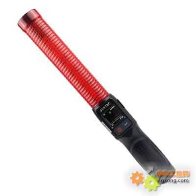

¾Æ¾«²âÊÔÒÇÊôÓڷǽӴ¥Ê½£¬ºôÆø¾ÍÄܲâÊԾƾ«Å¨¶ÈÖµ£¬´ó´óÌá¸ßÁ˼ì²âЧÂÊ¡£Ö÷ÒªÓ¦ÓÃÓ¦ÓÃÓÚ¹«½»¡¢Ìú·¡¢»·ÎÀ¡¢ÎïÁ÷µÈ½»Í¨ÔËÊäҵ˾»ú»ò¿ó¾®¡¢ÆóÊÂÒµµ¥Î»Ô±¹¤¸Úǰ´µÆø²âÊÔ£¬ÅŲ龯ºóÉϸڡ£
±ãЯʽ¾Æ¾«¼ì²âÒÇÊÇΪ½»Í¨ÔËÊä¡¢¿ó¾®µÈÆóÊÂÒµµ¥Î»¼ì²â˾»ú»òÔ±¹¤¾Æ¾«Å¨¶È¼ì²â¶øÉè¼Æ¡¢ÖÆÔì£¬ÌØµãÊÇ£º°ü×°¼òµ¥£¬Óû§¿É·½±ãЯ´ø£¬½øÐв»¶¨Ê±¡¢²»¶¨µãµÄÒÆ¶¯¼ì²â»òÁÙʱ³é¼ì£¬ÒÇÆ÷¿ª»ú¼´²â£¬ÎÞÐèÔ¤Èȵȴý£¬Ëٶȿ죬¿É×Ô/ÊÖ¶¯¸´Î»ÂֻزâÊÔ£¬²ÉÓùú±ê¼ÆÁ¿µ¥Î»£¬ÆÁĻŨ¶ÈÏÔʾ£¬¿É(Ñ¡)ÅäÖñãЯʽ΢ÐÍ´òÓ¡»ú£¬ÎÞÏß´òÓ¡²âÊÔ½á¹û¡£
ºôÆøÊ½¾Æ¾«¼ì²âÒÇÊǼì²â¼ÝÊ»ÈËÔ±ºôÆøÖоƾ«º¬Á¿µÄÒÇÆ÷¡£Ê¹Óüì²âʱ£¬ÒªÇó±»²âÕ߿ں¬´µ¹ÜºôÆø£¬¶Ô¼ÝÊ»ÈËÔ±½øÐÐÏÖ³¡¼ì²â£¬ÒÔÈ·¶¨±»²âÁ¿ÕßÊÇ·ñÊǾƺó¼ÝÊ»¡£Èç¹û¼ÝʻԱºô³öÆøÌåµÄ¾Æ¾«º¬Á¿³¬¹ýËù¹æ¶¨µÄÏÞÁ¿£¬ÒÇÆ÷¾Í»áÏÔʾ¡£Í¨¹ýºôÆø¾Æ¾«º¬Á¿ÅŲéÒÇ£¬¾ÍÄܼì²â³öÒû¾Æº¬Á¿£¬·ÀÖ¹¾Æºó¼ÝÊ»»òÕßÒû¾ÆÉϸڹ¤×÷¡£
¾Æ¾«º¬Á¿¼ì²âÒdz£ÓõÄÓÐȼÁÏµç³ØÐÍ£¨µç»¯Ñ§ÐÍ£©ºÍ°ëµ¼ÌåÐÍÁ½ÖÖ¡£
ȼÁÏµç³ØÊǵ±Ç°È«ÊÀ½ç¶¼Ôڹ㷺Ñо¿µÄ»·±£ÐÍÄÜÔ´£¬Ëü¿ÉÒÔÖ±½Ó°Ñ¿ÉÈ¼ÆøÌåת±ä³ÉµçÄÜ£¬¶ø²»²úÉúÎÛȾ£¬¾Æ¾«´«¸ÐÆ÷Ö»ÊÇȼÁÏµç³ØµÄÒ»¸ö·ÖÖ§¡£È¼ÁÏµç³Ø¾Æ¾«´«¸ÐÆ÷²ÉÓýðÊô×÷Ϊµç¼«£¬ÔÚȼÉÕÊÒÄÚ³äÂúÌØÖÖ´ß»¯¼Á£¬Ê¹½øÈëȼÉÕÊÒÄڵľƾ«³ä·ÖȼÉÕת±äΪµçÄÜ£¬Ò²¾ÍÊÇÔÚÁ½¸öµç¼«ÉϲúÉúµçѹ£¬µçÄÜÏûºÄÔÚÍâ½Ó¸ºÔØÉÏ£¬´ËµçѹÓë½øÈëȼÉÕÊÒÄÚÆøÌåµÄ¾Æ¾«Å¨¶È³ÉÕý±È¡£
´ÓÀíÂÛÉÏ˵£¬ÒªÅжÏÊÇ·ñÊǾƺó¼ÝÊ»£¬¼òµ¥¿ÉÐеķ½·¨ÊÇÏÖ³¡¼ì²â¼ÝÊ»ÈËÔ±ºôÆøÖеľƾ«º¬Á¿¡£´óÁ¿µÄͳ¼ÆÑо¿½á¹û±íÃ÷£¬Èç¹û±»²âÕßÉîÎüÆøºóÒÔÖеÈÁ¦¶ÈºôÆø´ïÈýÃëÖÓÒÔÉÏ£¬Õâʱºô³öµÄÆø¾ÍÊǴӷβ¿Éî´¦³öÀ´µÄÆøÌ壬ºôÆøÖеľƾ«º¬Á¿¾ÍÊÇѪҺÖеľƾ«º¬Á¿¡£

¾Æ¾«´«¸ÐÆ÷ÀàÐÍ
µç»¯Ñ§È¼ÁÏµç³ØÐ;ƾ«´«¸ÐÆ÷
Á¿³Ì·¶Î§
0¡«150mg/100ml  BAC(ѪҺ¾Æ¾«Å¨¶È£©
²âÁ¿Ä£Ê½
¿ìËÙɸ²é£¬×Ô¶¯³éÆøÊ½
×î´ó²âÁ¿Îó²î
ÒÇÆ÷Óë×ìÖ®¼ä¾àÀë
Îó²î
<5cm
±6.0mg/100ml
5cm~10cm
±8.0mg/100ml
>10cm
±15.0mg/100ml
³éÆø·½Ê½
µç»úÁ¬Ðø³éÆø£¬³éÆøËٶȲ»µÍÓÚ0. 8L/·ÖÖÓ
¹¤×÷ζȷ¶Î§
-5¡æ¡«45¡æ
Öü´æÎ¶ȷ¶Î§
£­30¡æ¡«70¡æ
²âÁ¿Ê±¼ä
Ö§³ÖÔÚÒÇÆ÷ÉÏ×Ô¼ºµ÷Õû£¬×î¿ì1Ãë³ö½á¹û
»·¾³Ñ¹Á¦
600¡«1400hPa
»·¾³Î¶È
20¡«98%r.h.
ÏÔʾÆÁ
OLEDÊý×ÖÏÔʾ
µç³Ø
1½Ú³äµçµç³Ø£¬3.7V/3000mAh
Á¬Ðø²âÁ¿Ê±¼ä
8СʱÒÔÉÏ
Âí´ïÌáʾ
¾Æ¾«Å¨µ×³¬¹ýÔ¤ÉèÖ÷¢³öÕñ¶¯Ìáʾ
Ö÷»ú³ß´ç
³¤£¨370£©XÍâ¾¶£¨145£©mm
ÒÇÆ÷ÖØÁ¿
Ô¼320g(±5g)£¨º¬µç³Ø£©
