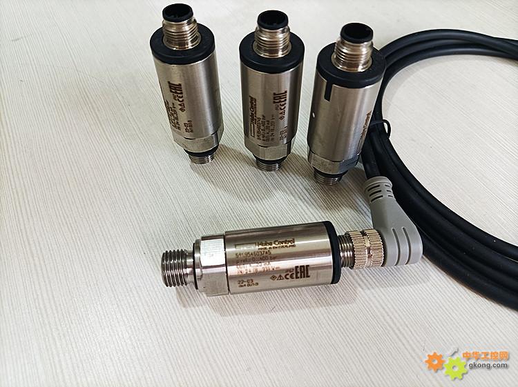

ÈðÊ¿¸»°Í511.954603745ѹÁ¦´«¸ÐÆ÷¼¼Êõ²ÎÊý
Ïà¶ÔѹÁ¦ -1¡«600bar
 0¡«25bar
¹ýÔØÑ¹Á¦ 3.0×ÂúÁ¿³Ì£¨ÔÚÁ¿³ÌΪ-1¡«4bar£©
2.5×ÂúÁ¿³Ì£¨ÔÚÁ¿³ÌΪ6¡«400bar£©
2.0×ÂúÁ¿³Ì£¨ÔÚÁ¿³ÌΪ600bar£©
ÆÆÁÑѹÁ¦ 3.0×ÂúÁ¿³Ì£¨ÔÚÁ¿³ÌΪ-1¡«4bar£©
·À»¤µÈ¼¶ IP67
Íâ¿Ç²ÄÖÊ ²»Ðâ¸Ö1.4305£¨AISI 303£©
ζȷ¶Î§ -15¡æ¡«£«125¡æ
Ó¦ÓÃζÈ(ÃÜ·âÇé¿öϵĽéÖÊζÈ)
FPM -15¡«125¡æ£»NBR -25¡«85¡æ
FPM£¨spec£©-40¡«150¡æ
µç ѹ 8.0¡«33VDC,Êä³ö4-20mA
ÃÜ·â²ÄÖÊ Ñ¡Ïî²ÄÁÏFPM,NBR,»òÆäËü¿Í»§ÒªÇó
ÖØ Á¿ ÄÚÂÝÎÆ85¿Ë,ÍâÂÝÎÆ95¿Ë
¾« ¶È ¾«¶ÈÏßÐÔ,³ÙÖÍ,ºÍÖØ¸´ÐÔµÄ×ܺÍ<±0.3% FS
¶¯Ì¬ÏìÓ¦ ¿ÉÊʺϾ²Ì¬ºÍ¶¯Ì¬µÄ²âÁ¿
ÏìӦʱ¼ä<2ms,ͨ³£Îª1ms
