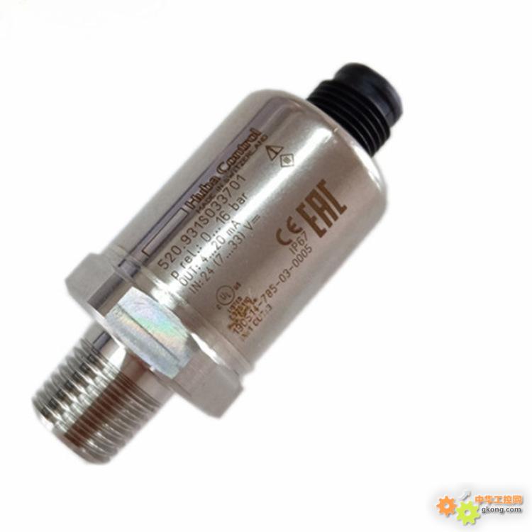

²úÆ·Ãû³Æ£º HUBA520.933S033401¸»°ÍѹÁ¦´«¸ÐÆ÷½ø¿Ú
ÐÍ ºÅ£º 520.933S033401
²úÆ·ÌØµãÈçÏ£º
1.ѹÁ¦·¶Î§£ºÏà¶ÔѹÁ¦-1¡«600bar£¬¾øÑ¹025bar.
2.¹ýÔØÑ¹Á¦
3.0×ÂúÁ¿³Ì£¨ÔÚÁ¿³ÌΪ-1¡«4bar£©2.5×ÂúÁ¿³Ì£¨ÔÚÁ¿³ÌΪ6¡«400bar£©2.0×ÂúÁ¿³Ì£¨ÔÚÁ¿³ÌΪ600bar£©
3. .ÆÆÁÑѹÁ¦3.0×ÂúÁ¿³Ì£¨ÔÚÁ¿³ÌΪ-1¡«4bar£©2.5×ÂúÁ¿³Ì£¨ÔÚÁ¿³ÌΪ6¡«400bar£©2.0×ÂúÁ¿³Ì£¨ÔÚÁ¿³ÌΪ600bar£©
4.·À»¤µÈ¼¶£ºIP67
5.Íâ¿Ç²ÄÖÊ£º²»Ðâ¸Ö1.4305£¨AISI 303£©
6.ζȷ¶Î§£º-15¡æ¡«£«125¡æ
7.Ó¦ÓÃζÈ(ÃÜ·âÇé¿öϵĽéÖÊζÈ)
FPM -15¡«125¡æNBR -25¡«85¡æFPM£¨spec£©-40¡«150¡æ
8.µçѹ8.0¡«33VDC£¬Êä³ö4-20mA
8.ÓÅÔ½µÄµç´Å¼æÈÝ£¨EMC£©
9.ÃÜ·â²ÄÖÊ£º Ñ¡Ïî²ÄÁÏFPM£¬NBR£¬»òÆäËü¿Í»§ÒªÇó
10.ÖØÁ¿£ºÄÚÂÝÎÆ85¿Ë£¬ÍâÂÝÎÆ95¿Ë
11.µçÔ´·´Ïà±£»¤£¬¾²µç±£»¤500VDC
12.¾«¶È£º¾«¶È ÏßÐÔ£¬³ÙÖÍ£¬ºÍÖØ¸´ÐÔµÄ×ܺͱ0.3% FS
13.¹ý½éÖÊֹͣϵͳ£¨±¬ÆÆË¨£©
14.¶¯Ì¬ÏìÓ¦£º¿ÉÊʺϾ²Ì¬ºÍ¶¯Ì¬µÄ²âÁ¿£¬ÏìӦʱ¼ä2ms£¬Í¨³£Îª1ms
15. Quickon¿ìËÙÁ¬½á£¬½ÚÊ¡60%ÅäÏßʱ¼äUL¡¢CSA¡¢CEÈÏÖ¤
²úÆ·ÌØµãÈçÏ£º
1.ѹÁ¦·¶Î§£ºÏà¶ÔѹÁ¦-1¡«600bar£¬¾øÑ¹0…25bar.
2.¹ýÔØÑ¹Á¦
4.·À»¤µÈ¼¶£ºip67
5.Íâ¿Ç²ÄÖÊ£º²»Ðâ¸Ö1.4305£¨aisi 303£©
fpm -15¡«125¡ænbr -25¡«85¡æfpm£¨spec£©-40¡«150¡æ
8.µçѹ8.0¡«33vdc£¬Êä³ö4-20ma
8.ÓÅÔ½µÄµç´Å¼æÈÝ£¨emc£©
9.ÃÜ·â²ÄÖÊ£º Ñ¡Ïî²ÄÁÏfpm£¬nbr£¬»òÆäËü¿Í»§ÒªÇó
11.µçÔ´·´Ïà±£»¤£¬¾²µç±£»¤500vdc
12.¾«¶È£º¾«¶È ÏßÐÔ£¬³ÙÖÍ£¬ºÍÖØ¸´ÐԵĺͱ0.3% fs
