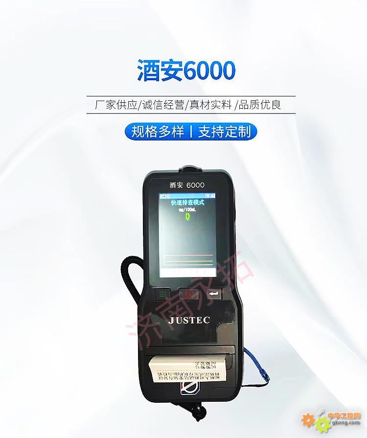

²úÆ·Ãû³Æ£º ¾Æ°²6000¾Æ¾«²âÊÔÒǺôÆøÊ½
ÐÍ ºÅ£º ¾Æ°²6000
¾Æ°²6000Ö÷»ú²ÉÓøßÐÔÄÜ¡¢´¦ÀíÄÜÁ¦Ç¿´óµÄ32λǶÈëʽ´¦ÀíÆ÷¡¢¸ß¾«¶ÈµÄÈ«½ðÊôÆø±Ã²ÉÑùϵͳ¼°ÏȽøµÄËã·¨ºÍ¿ìËÙ¸´Áãµç·Éè¼Æ£¬Ê¹µÃ²âÊÔËÙ¶È´ó´óÌá¸ß£¬¶øÇÒ²âÊÔÇåÁãʱ¼äÃ÷ÏÔËõ¶Ì£»´òÓ¡»úÓëÖ÷»úΪһÌ壬²âÊÔÍê³ÉºóÁ¢¼´´òÓ¡½á¹û¡£
¼¼Êõ²ÎÊý£º
씀
Ö¸±ê¼°²ÎÊý
²âÁ¿Ä£Ê½
Ö÷¶¯´µÆøÄ£Ê½---È¡Óã¬Á¬Ðø±»¶¯Ä£Ê½---ÅŲéÓÃ
´«¸ÐÆ÷
ȼÁÏµç³Øµç»¯Ñ§¾Æ¾«´«¸ÐÆ÷
ÊäÈ뷽ʽ
3.2Ó¢´ç´¥ÃþÆÁ+3¸ö°´¼ü
ÊäÈëÄÚÈÝ
³µÅƺţ¬¾¯ºÅ£¬¼Ýʻ֤ºÅµÈ
´òÓ¡·½Ê½
ÓëÖ÷»úÒ»Ì廯
Ö÷¶¯Ä£Ê½——ȡģʽ
²âÁ¿·¶Î§£¨BAC£©
0-550mg/100ml
ѪҺ¾Æ¾«Å¨¶È·¶Î§£¨BAC£©
Îó²î
0-100mg/100ml
±5mg/100ml
100-200mg/100ml
±5%
£¾200mg/100ml
±10%
±»¶¯Ä£Ê½——ÅŲéģʽ
²âÁ¿·¶Î§£¨BAC£©
0-100mg/100ml
ÁéÃô¶È
·Ç³£ÁéÃô
±¨¾¯
ºì»ÆÂÌÈý¼¶±¨¾¯£¬±¨¾¯Å¨¶È¿ÉÉ趨
²âÁ¿Ê±¼ä
Óû§¿ÉÒÔÔÚÒÇÆ÷ÉÏ×Ô¼ºµ÷Õû
¶Ì
1Ãë
³¤
15Ãë
ĬÈÏ
8Ãë
¹¤×÷ζȷ¶Î§
-30¡æ¡«60¡æ
Öü´æÎ¶ȷ¶Î§
-40¡æ¡«70¡æ
´µÆøÁ¿
1.0L£¬2.5Ãë
´µ¹Ü
µ¥ÏòÒ»´ÎÐÔ»ò¸ù¾Ý¿Í»§ÐèÒª
Ô¤ÈÈʱ¼ä
5S
¹éÁãʱ¼ä
ǰһ´Î²âÁ¿ÖµÎª£º0-100mg/100ml     Ô¼3Ãë
ǰһ´Î²âÁ¿ÖµÎª£º100-200mg/100ml   Ô¼5Ãë
ǰһ´Î²âÁ¿ÖµÎª£º£¾200mg/100ml     Ô¼7Ãë
Ö÷»úµç³Ø
2000mAh/7.4Vï®Àë×Ó³äµçµç³Ø
µç³Ø²âÁ¿´ÎÊý
Ò»´Î³äÂúµç¿É¹¤×÷1000´Î²âÊÔ
ÏÔʾÆÁ
3.2Ó¢´ç¡¢26ÍòÉ«£¬È«²ÊÉ«µãÕóÒº¾§´¥ÃþÆÁ
´æ´¢Æ÷
ÈÕÆÚ¡¢Ê±¼ä¡¢³µÅƺ𢾝ºÅ¡¢¼Ýʻ֤ºÅµÈÐÅÏ¢£¨5ÍòÌõ¼Ç¼£©
У׼ÖÜÆÚ
ÿ6¸öÔÂÒ»´Î»ò¸ù¾ÝÏà¹ØÒªÇó
