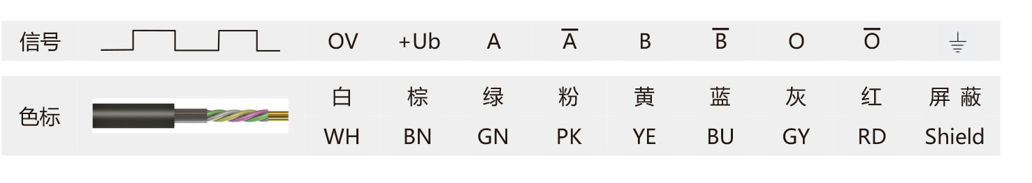

Êä ³öÍÆÍì¡¢ÍÆÍì²î·Ö¡¢¼¯µç¼«¿ªÂ·¡¢RS422(TTL¼æÈÝ)
¹¤×÷µçѹ5V¡¢5-30V¡¢9-26V

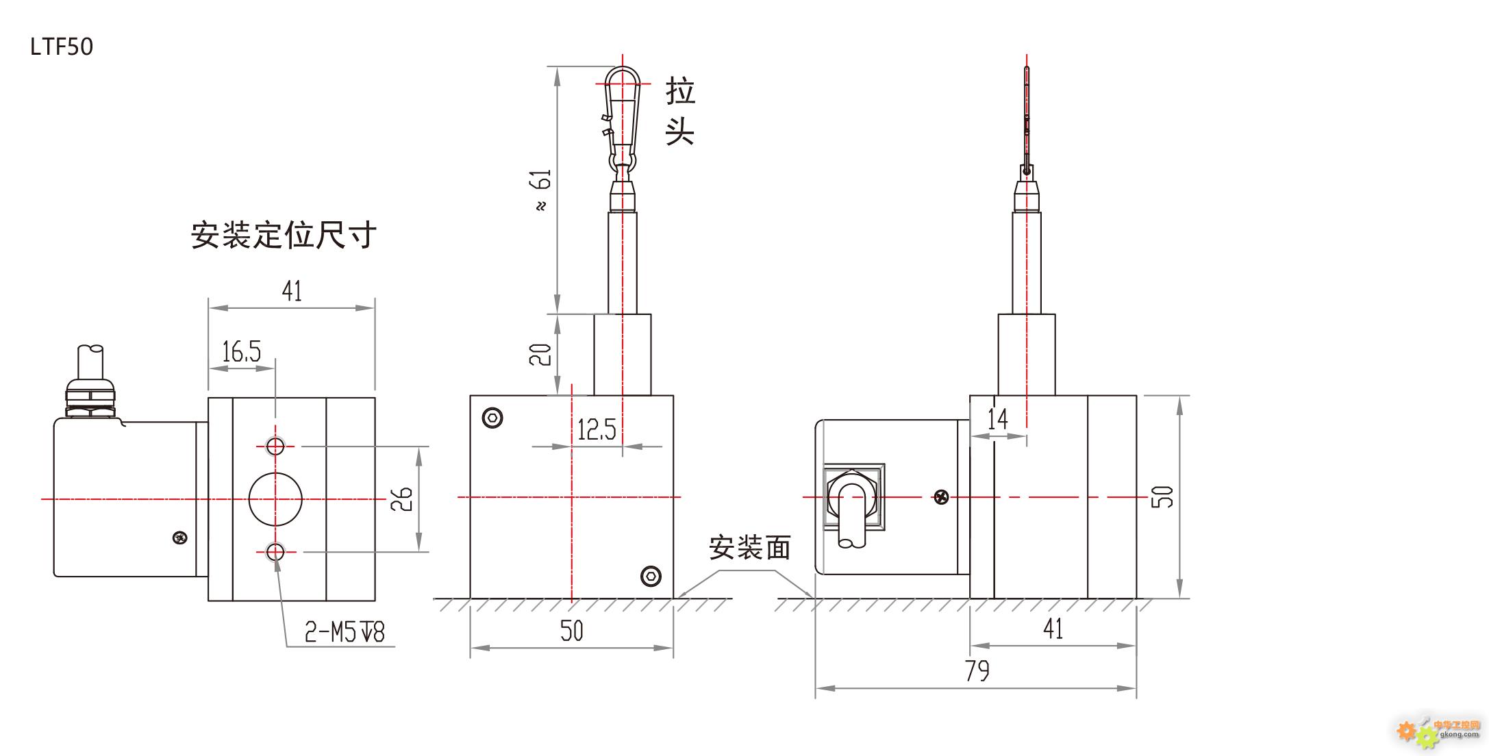

»úеͼ
