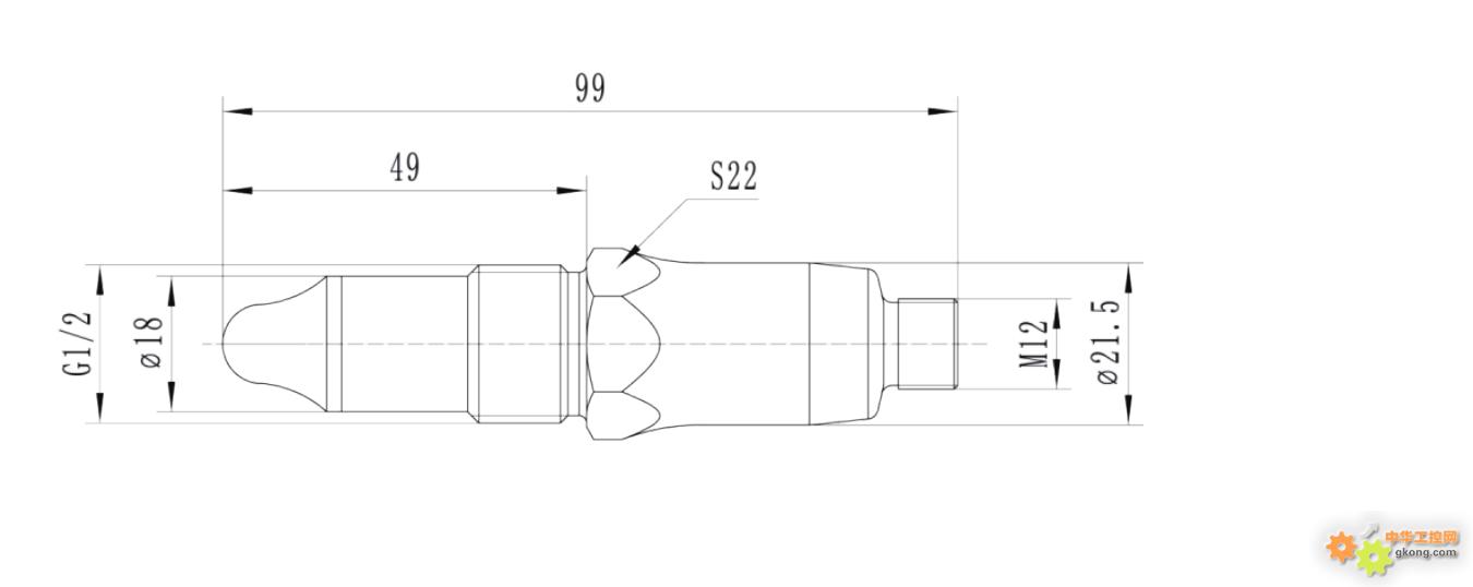

»úе²ÎÊý
Íâ¿Ç³ß´ç    M18xL=99mm
²ÄÖÊ     PEEK¼°316L²»Ðâ¸Ö
µçÀÂÏß/Á¬½ÓÆ÷¹æ¸ñ   M12 4ÕëÁ¬½ÓÆ÷
Íâ¿Ç·À»¤µÈ¼¶   IP67
Ðý½ôÁ¦¾Ø   15-20N.m

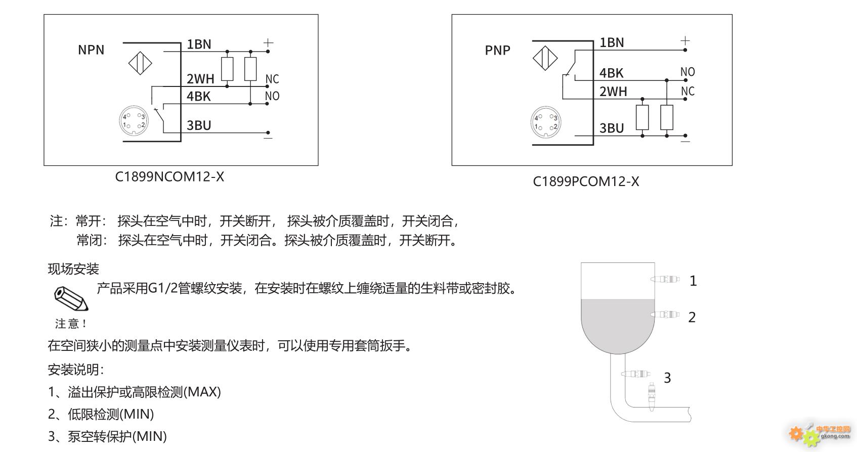

¶Ë×ÓÅäÖÃͼ

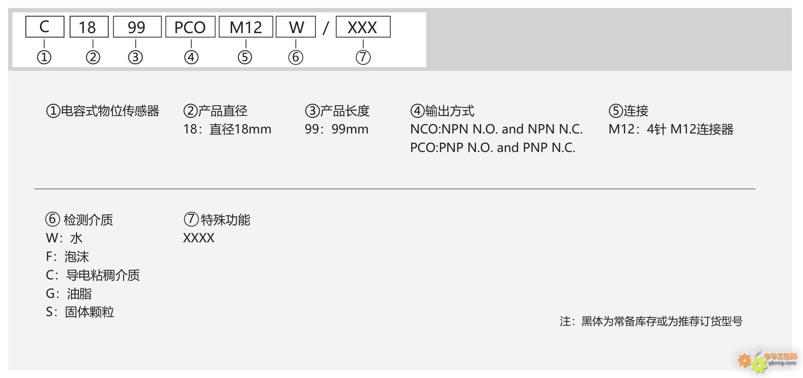

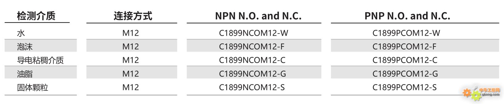

¶©»õÐÅÏ¢
²úÆ·Ñ¡Ôñ
»úеͼ
