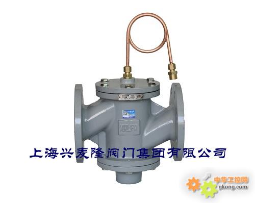

²úÆ·Ãû³Æ£º ×ÔÁ¦Ê½Ñ¹²î¿ØÖÆ·§
ÐÍ ºÅ£º DPZYC
 DPZYCÐÍ×ÔÁ¦Ê½Ñ¹²î¿ØÖÆ·§
²úÆ·¸ÅÊö£º
   DPZYCÐÍ×ÔÁ¦Ê½Ñ¹²î¿ØÖÆ·§£¬ÊÇÒ»ÖÖÀûÓýéÖÊ×ÔÉíµÄѹÁ¦±ä»¯½øÐÐ×ÔÎÒ¿ØÖƶø±£³ÖÁ÷¾­¸Ã±»¿ØÏµÍ³½éÖÊѹ²î²»±äµÄ·§ÃÅ¡£ÊÊÓÃÓÚ¹©Å¯·½Ê½²ÉÓÃË«¹ÜϵͳµÄѹ²î¿ØÖÆ£¬±£³Öϵͳѹ²î»ù±¾²»±ä£¬½µµÍÔëÒô£¬Æ½ºâ×èÁ¦£¬Ïû³ýÈÈÍøºÍË®Á¦Ê§µ÷¡£
   ¼¼Êõ¹æ·¶
ÐͺÅ
¹«³ÆÑ¹Á¦
¿ÇÌåʵÑéѹÁ¦
ѹ²î¿ØÖÆ·¶Î§
¶¨Ñ¹²îÐÍ
¿Éµ÷ѹ²îÐÍ
 DPZYC-16
1.6MPA
2.4MPA
10kpa¡¢20kpa¡¢30kpa
10-30kpa
Ö÷ÒªÍâÐͳߴç
DN
Á¬½Ó·½Ê½
L
          H
Á÷Á¿
ÊÊÓýéÖÊ
½éÖÊζÈ
Ö÷ÒªÁã¼þ²ÄÁÏ
¶¨Ñ¹²îÐÍ
¿Éµ÷ѹ²îÐÍ
15
ÂÝÎÆ
110
95
145
0.2-1
Ë®
0-100¡æ
·§Ì壬ÉϸǺÍϸÇΪÖýÌú£¬·§Ð¾ÎªÍ­£¬Ä¤Æ¬ÎªÄáÁúÇ¿»¯Ï𽺡¢µ¯»ÉΪ²»Ðâ¸Ö
20
110
110
150
0.3-1.5
25
115
130
165
0.5-2
30
·¨À¼
130
140
190
1-4
40
200
190
340
1.5-6
215
205
355
2-8
65
230
240
390
3-12
80
275
300
500
5-20
100
290
350
550
10-30
125
310
380
680
15-45
150
350
30-80
200
430
40-180
250
520
100-300
300
635
150-500
350
670
200-700
