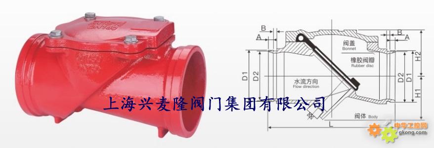

²úÆ·Ãû³Æ£º ¹µ²ÛʽÏ𽺰êÖ¹»Ø·§
ÐÍ ºÅ£º CV84X
CV84X¹µ²ÛʽÏ𽺰êÖ¹»Ø·§
²úÆ·¸ÅÊö£º
   CV84X¹µ²ÛʽÏ𽺰êÖ¹»Ø·§Ö÷ÒªÓÉ·§Ì壬·§¸Ç£¬¼°·§°êÈýÖÖÖ÷ÒªÁã¼þ×é³É¡£ÆäÖÐÏ𽺰êÓɸְå×÷³Ðѹ¼þ¼°Ç¿»¯ÄáÁú²¼×ö³Äµ×£¬Íâ²ã²ÉÓÃÈÈÁò»¯ÕûÌå°ü½º¼¼Êõ×é³É£¬·§×ù²ÉÓÃÌÕ´ÉÅçÍ¿¹¤ÒÕʹ·§ÃŵÄÊÙÃü¸ü³¤¡£¸Ã·§²ÉÓÃÈ«Á÷Ãæ»ýʽÉè¼Æ£¬¾ßÓÐˮͷËðʧС£¬²»Ò×¶Ñ»ýÔÓÎͬʱ¸Ã·§¾ßÓа²×°¼òÒס¢Ê¡²ÄÊ¡¿Õ¼äÌØµã£¬¹Ê¹ã·ºÊÊÓÃÓÚÊÐÕþ¡¢Ãñ½¨¡¢¹¤ÒµµÈÅÅË®ºÍÏû·Àϵͳ¡£
¸Ã·§ÓÉÓÚÐгÌС£¬Ðг̽Ç35¡æ¼´¿É´ïµ½È«¹Ø±Õ¡£¹Ø±ÕËٶȿ죬¿É°²×°ÓÚË®±Ã³ö¿Ú´¦ÒÔ¼õСˮ´¸¶ÔË®±ÃµÄË𺦡£ÁíÍâ¸Ã·§»¹¿É°²×°ÐîË®³Ø½ø³öË®¹ÜµÄÅÔͨ¹ÜÉÏ£¬ÒÔ¸¨Öú³ØË®µ¹Á÷ÖÁ¸øË®ÏµÍ³ÖС£
Ö÷ÒªÍâÐÎÁ¬½Ó³ß´ç
¿Ú¾¶DN
L
D1
D2
A
B
H1
H2
¹µ²ÛÐͺÅ
203
57
53.9
16
8
60
80
X
60.3
57.2
Y
65
216
73
69.1
65
75
X
76.1
72.3
Y
80
241
88.9
85
75
90
X
100
292
108
103.7
9.5
100
108
X
114.3
110.1
Y
150
381
159
154.5
135
145
X
165.1
160.8
Y
168.3
164
Z
200
495
219.1
214.4
19
11.1
170
185
X
