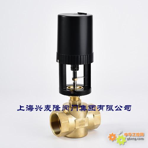

²úÆ·Ãû³Æ£º ÐËÂó¡±ÈÀý»ý·Öµç¶¯¶þͨµ÷½Ú·§
ÐÍ ºÅ£º ET7200
              ET7200±ÈÀý»ý·Öµç¶¯µ÷½Ú·§
   ET7200ϵÁе綯µ÷½Ú·§ÊÇÓÉ×÷ÓÃÁ¦1000Nµç¶¯Ö´ÐÐÆ÷Óë¿Ú¾¶DN20-DN65µ÷½Ú·§Ìå×éºÏ¶ø³ÉµÄµç¶¯µ÷½Ú·§ÏµÁУ¬Æä¹ã·ºÓ¦ÓÃÓÚ¿Õµ÷ÖÆÀ䣬²ÉůÒÔ¼°Â¥Óî×Ô¶¯¿ØÖÆÏµÍ³ÖУ¬¿É¾«È·µ÷½ÚϵͳÖеĽéÖÊÁ÷Á¿£¬´Ó¶ø´ïµ½¿ØÖÆÎ¶ȣ¬Êª¶È£¬Ñ¹Á¦ºÍ½ÚÄܵÄÄ¿µÄ¡£
   ²úÆ·ÌØµã£º
 1.Ö´ÐÐÆ÷Ö®¼Ò²ÉÓÃÂÁѹÖý³ÉÐÍ£¨±íÃæ¾­Åçɰ¿¾Æá´¦Àí£©Íâ¿ÇÓÃABS¹¤³ÌËÜÁÏ£¬Ìå»ýС£¬ÖØÁ¿Çá¡£
2.Ö´ÐÐÆ÷Ñ¡ÓÿÉÄæÍ¬²½µç»ú£¬¾ßÓйýÔØÏÞλ¿ª¹Ø±£»¤¹¦ÄÜ£¬´øÏÞλ¿ª¹Ø£¬Ö´ÐÐÆ÷µç»ú×ÔÐÐÍ£Ö¹¡£
3.¹¤×÷µçѹ£ºAC24V±10% 50/60Hz(Ò²¿ÉÒÔ¶©ÖÆÑ¡ÓÃAC220V£©
4. ¿ØÖÆÐźţº¿ª¹Ø/¸¡µãÐźÅ/¿ª¹Ø´øÎÞÔ´Ðźŷ´À¡
Ä£Ä⣺0-10V/4-20mA·´À¡Êä³ö¿ÉÑ¡µçѹ0-10V¡¢»òµçÁ÷ÐźÅ4-20mA DC¡£
·§Ìå¼¼Êõ²ÎÊý
·§ÌåÐͺÅ
DN20
DN25
DN32
DN40
DN50
DN65
·§¸ËÐгÌ
20
20
20
20
20
20
ѹ²î£¨mpa£©
0.3
20
0.3
0.3
0.3
0.3
Á÷Á¿ÏµÊýKVÖµ
10
10
16
25
40
63
¹«³ÆÑ¹Á¦
1.6mpa
ÒºÌåζÈ
Ë®-10¡æ-95¡æ ÕôÆû-10¡æ-180¡æ
½éÖÊ
Àä/ÈÈË®£¬ÕôÆûµÈ
 ²ÄÖÊ
·§Ìå
»ÆÍ­¡¢²»Ðâ¸Ö¡¢Öý¸Ö£¨ÕôÆûÐëÑ¡Ôñ·¨À¼Öý¸Ö¡¢²»Ðâ¸Ö·§Ìå
·§Ð¾
»ÆÍ­£¬²»Ðâ¸Ö
·§¸Ë
²»Ðâ¸Ö
ÃÜ·â
ËÄ·úÌî³ä£¬VÐÍÃܷ⣬µ¯»É×Ô²¹³¥¡¢WCB¡¢304
й©Á¿
µ¥×ù·§Ð¡ÓÚKVÖµµÃ0.04%
Ö´ÐÐÆ÷¼¼Êõ²ÎÊý
Ö´ÐÐÆ÷ÐͺÅ
ET7200-1003
ET7200-1002
ET7200-1001
¶¯×÷/¿ØÖÆ
¿ÉÄæµÄ£¬µÝÔö¿ØÖÆ
¿ÉÄæµÄ£¬µÝÔö¿ØÖÆ
±ÈÀýÊ½ÖÆÐÍÕýת»ò·´×ª
µçÔ´µçѹ
AC220V 50/60HZ±10%
AC24V 50/60HZ±10%
AC24V 50/60HZ±10%
µç»úÐÍʽ
½»Á÷ÓÀ´Åͬ²½¿ÉÄæ»úµç
×÷ÓÃÁ¦
1000N
1000N
1000N
¿ØÖÆÐźÅ
ÔöÁ¿/¿ª¹ØÐźÅ
¿ª¹Ø/ÔöÁ¿/¸¡µãÐźÅ
0£¨2£©~10VDC»ò0£¨4£©~20mADC
·´À¡ÐźÅ
ÎÞÔ´Ðźţ¨¿ÉÑ¡ÓÐÔ´£©
¹¦ÂÊÏûºÄ
7.5VA
7.5VA
7.5VA
ÐгÌ
25mm
25mm
25mm
¹¤×÷ζÈ
-10~-90
-10~-90¡æ
-10~-9¡æ
¹¤×÷ʪ¶È
10%90%RHÎÞ½á¶
Ö÷ÒªÍâÐÎÁ¬½Ó³ß´ç
·§ÌåÐͺÅ
¹æ¸ñ
ÐÎʽ
×î´óѹ²îMPa
KVÖµ
³ß´ç£¨L
³ß´ç£¨H+H1£©
GS6620
DN20
¶þͨ
0.3
8
10
28
GS6620
DN25
¶þͨ
0.3
10
11
29
GS6620
DN32
¶þͨ
0.3
16
12
32
GS6620
DN40
¶þͨ
0.3
25
12.5
35
GS6620
DN50
¶þͨ
0.3
40
13
35
GF8042
DN65
¶þͨ
0.3
65
25.5
47
GS6620-3
DN25
Èýͨ
0.3
10
11
35
GS6620-3
DN32
Èýͨ
0.3
16
12
35
GS6620-3
DN40
Èýͨ
0.3
25
12.5
41
GS6620-3
DN50
Èýͨ
0.3
40
13
41
GF8042-3
DN65
Èýͨ
0.3
63
25.5
52
