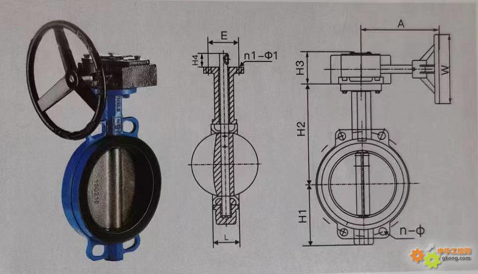

  ²úÆ·¸ÅÊö
CB6100WϵÁÐÎÏÂÖ¶Ô¼ÐʽÖÐÏßµû·§ÊÊÓÃÓÚζÈ≤120¡æ£¬¹«³ÆÑ¹Á¦≤1.6MPaµÄʳƷ¡¢Ò½Ò©¡¢»¯¹¤¡¢Ê¯ÓÍ¡¢µçÁ¦¡¢Çá·Ä¡¢ÔìÖ½µÈ¸øÅÅË®¡¢ÆøÌå¹ÜµÀÉÏ×÷µ÷½ÚÁ÷Á¿ºÍ½Ø¶ÏÁ÷ÌåµÄ×÷Óá£ÆäÖ÷ÒªÌØµãΪ£º
  1. Éè¼ÆÐÂÓ±¡¢ºÏÀí¡¢½á¹¹½ô´Õ£¬ÖØÁ¿ÇᣬÆô±ÕѸËÙ¡£
  2. ²Ù×÷Á¦¾ØÐ¡£¬²Ù×÷·½±ã£¬Ê¡Á¦ÁéÇÉ¡£
  3. ¿ÉÒÔÈκÎλÖð²×°£¬Î¬ÐÞ·½±ã¡£
  4. ÃÜ·â¼þ¿ÉÒÔ¸ü»»£¬ÃÜ·âÐÔÄܿɿ¿£¬Äܹ»´ïµ½Ë«ÏòÃÜ·âÁãй©¡£
  5. ÃÜ·â²ÄÁϾßÓÐÄÍÀÏ»¯¡¢Ä͸¯Ê´¡¢Ê¹ÓÃÊÙÃü³¤µÈÌØµã¡£
Ö÷ÒªÍâÐÎÁ¬½Ó³ß´ç£¨PN16£©
DN£¨mm£©
NPS
L
H1
H2
H3
H4
n-φ
A
E
N1-φ1
W
200
8
60
175
260
82
45
4-25
240
88.9
4-14.3
298
4-23
250
10
68
203
292
82
45
4-29
240
88.9
4-14.3
298
300
12
78
242
337
84
45
4-29
225
107.95
4-14.3
298
350
14
78
267
368
84
45
4-30
225
107.95
4-14.3
298
400
16
102
325
400
120
51.2
4-26
280
158.75
4-20.6
300
88
72
4-30
450
18
114
345
422
120
51.2
4-26
362
158.75
4-20.6
300
107
72
4-30
500
20
127
378
480
150
64.2
4-26
362
158.75
4-20.6
300
82
4-33
600
24
154
475
562
150
70.2
4-30
362
215.9
4-22.2
300
82
4-26
