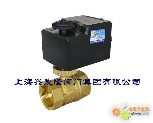

²úÆ·Ãû³Æ£º »ÆÍ­µç¶¯Çò·§
ÐÍ ºÅ£º BV2054
BV2054µç¶¯µ÷½ÚÇò·§²úÆ·Ïêϸ½éÉÜ£º
¹¦Äܼ°Ó¦ÓÃ
 BVϵÁе綯ִÐÐÆ÷¡¢»ÆÍ­µ÷½ÚÇò·§×é³É¡¢Ö÷ÒªÓÃÓÚÖÐÑë¿Õµ÷ÀäÈÈˮϵͳ£¬°´Êµ¼ÊÐèÒª¾«È·¿ØÖÆÀä¡¢ÈȽéÖʵÄÁ÷Á¿£¬²»»áÔì³ÉζȵľçÁұ仯£¬´ïµ½ÊµÊ±¾«È·¿ØÖÆÊÒÎÂ֮ĿµÄ¡£
·§Ìå¼¼Êõ²ÎÊý£º
¹«³ÆÍ¨¾¶
DN20
DN25
DN32
DN40
DN50
Á÷Á¿ÏµÊý
12.5
19.1
27.8
45.3
90
½Ç¶È·¶Î§
0-90¡æ
¹«³ÆÑ¹Á¦
1.6MPa
Á÷Á¿ÌØÐÔ
µÈ°Ù·Ö±È
ÔÊÐíй©Á¿
≤kvsÖµµÄ0.01£¥£¨Á½Í¨£©; ≤kvsÖµµÄ1£¥£¨Èýͨ£©
½éÖÊζÈ
-20¡æ¡«95¡æ
Á¬½ÓÐÎʽ
ÂÝÎÆÁ¬½Ó
Ö÷ÒªÁã¼þ²ÄÁÏ
·§Ì壺¶ÍÔì»ÆÍ­
Çòо£º²»Ðâ¸Ö
·§×ù£º¾ÛËÄ·úÒÒÏ©
·§¸Ë£º»ÆÍ­
Ö´ÐÐÆ÷¼¼Êõ²ÎÊý£º
¿ØÖÆÀàÐÍ
Èýλ¸¡µãÐÍ
±ÈÀýµ÷½ÚÐÍ
µçÔ´µçѹ
AC24V/AC220
Ac24V
ƵÂÊ
50/60HZ
Ť¾Ø
8NM
ÔËÐÐʱ¼ä
80 S-90S
ÔËÐй¦ÂÊ
8.0W
´ý»ú¹¦ÂÊ
0.2W
µçÁ÷
3A AC250V
¿ØÖÆÐźÅ
ÈýÏßÖÆ
DC0-10v
·´À¡ÐźÅ
ÎÞ
DC0-10v
λÖÃÐźÅ
ÓÐλÖÃָʾװÖã¬ÄÜËæÊ±¹Û²ì·§ÃŵĿª¹Ø¼°¿ª¶ÈÇé¿ö
Ðýת½Ç¶È
0-90¡æ
ÊÙÃü
Ðýת60000£¨Ôڶ¸ºÔØÏ£©
ÔëÒô
©‚45dB
±£»¤¼¶±ð
Íâ¿Ç·À»¤µÈ¼¶
IP54
»·¾³Î¶È
-10¡«50¡æ
»·¾³Êª¶È
5¡«95£¥RH
´¢´æÎ¶È
-30¡«+60¡æ
