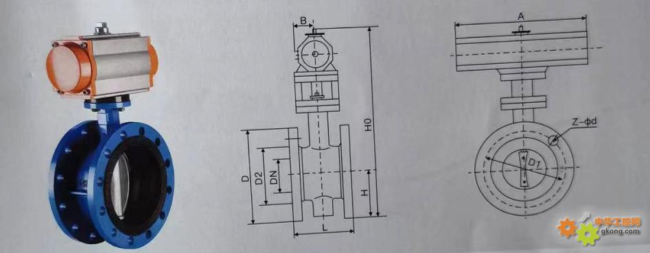

²úÆ·Ãû³Æ£º ·¨À¼Æø¶¯µû·§
ÐÍ ºÅ£º D641X
D641XÆø¶¯·¨À¼Ê½ÈíÃÜ·âµû·§
   ²úÆ·¸ÅÊö
       D641XÆø¶¯·¨À¼Ê½ÈíÃÜ·âµû·§ÍâÐÎÃÀ¹Û£¬Æä·§Ìå¡¢·§°å¡¢·§ÖáΪͬÐĽṹÉè¼Æ¡£µû·§½á¹¹½ô´Õ£¬90¡æ»Ø×ª¿ª¹ØÇáËÉ£¬¾ßÓÐÃÜ·â¿É¿¿¡¢Ê¹ÓÃÊÙÃü³¤µÈÌØµã¡£ÓëZMAÆø¶¯Ö´ÐÐÆ÷ÏàÅ䣬·§°êÓë·§Öá²ÉÓÃÎÞÉÔÁ¬½Ó£¬½éÖÊÓë·§Öá·§ÌåÍêÈ«¸ôÀ룬ά»¤¼ò±ãÒ×ÐУ¬Ë«ÏòÆøÅݼ¶Ãܷ⣬Íâ±í²ÉÓû·ÑõÊ÷Ö¬ÅçËÜ´¦Àí£¬´ïµ½»·±£±ê×¼¡£¹ã·ºÓ¦ÓÃÓÚʳƷ¡¢»·±£¡¢ÇṤ¡¢Ê¯ÓÍ¡¢ÔìÖ½¡¢»¯¹¤¡¢µçÁ¦µÈÐÐÒµµÄ¹¤Òµ×Ô¶¯»¯ÏµÍ³ÖУ¬×÷Ϊµ÷½ÚºÍ½ØÖ¹Ê¹Óá£
²úÆ·ÌØµã
  1. ±¾·§²ÉÓÃ˫ƫÐĽṹ£¬¾ßÓÐÔ½¹ØÔ½½ôµÄÃܷ⹦ÄÜ£¬ÃÜ·âÐÔÄܿɿ¿£º
  2. Ãܷ⸱²ÄÁÏÑ¡Óò»Ðå¸ÖºÍ¶¡ÇçÄÍÓÍÏð½ºÅä¶Ô£¬Ê¹ÓÃÊÙÃü³¤£º
  3. Ïð½ºÃÜ·âȦ¼È¿ÉλÓÚ·§ÌåÉÏ£¬Ò²¿ÉÒÔλÓÚµû°åÉÏ£¬¿ÉÊÊÓò»Í¬ÌصãµÄ½éÖÊ£¬¹©Óû§Ñ¡Ôñ£º
  4. µû°å²ÉÓÿò¼Ü½á¹¹£¬Ç¿¶È¸ß£¬¹ýÁ÷Ãæ»ý´ó£¬Á÷×èС£º
  5. ÕûÌ忾Æá¡¢ÄÜÓÐЧµØ·ÀÖ¹ÐåÊ´ÇÒÖ»Òª¸ü»»ÃÜ·â·§×ù²ÄÁÏ£¬¾Í¿ÉÒÔʹÓÃÓÚ²»Í¬½éÖÊ£º
  6. ·§Ìå¾ßÓÐË«ÏòÃܷ⹦ÄÜ£¬°²×°Ê±²»ÊܽéÖÊÁ÷ÏòµÄ¿ØÖÆ£¬Ò²²»ÊܿռäλÖõÄÓ°Ï죬¿ÉÔÚÈκη½Ïò°²×°£º
  7. ±¾·§½á¹¹¶ÀÌØ£¬²Ù×÷Áé»î¡¢Ê¡Á¦·½±ã¡£
²úÆ·Ö´Ðбê×¼
Éè¼ÆÓëÖÆÔì
GB/T 12238
·¨À¼Á¬½Ó
GB/T 9113
GB/T 17241.6
½á¹¹³¤¶È
GB/T 12221
ÊÔÑéºÍ¼ìÑé
GB/T 13927
¼¼Êõ²ÎÊý
¹«³ÆÍ¨¾¶
DN£¨mm£©
50-1200
¹«³ÆÑ¹Á¦
PN(MPa)
0.6
1.0
1.6
ÊÔÑéѹÁ¦
¿ÇÌåÇ¿¶ÈÊÔÑé
0.9
1.5
2.4
ÃÜ·âÊÔÑé
0.66
1.1
1.76
ÆøÃÜ·âÊÔÑé
0.6
0.6
0.6
ÊÊÓýéÖÊ
¿ÕÆø¡¢Ë®¡¢ÎÛË®¡¢ÕôÆû¡¢ÓÍÆ·µÈ
Çý¶¯ÐÎʽ
Æø¶¯
Ö÷ÒªÁã¼þ²ÄÁÏ
Áã¼þÃû³Æ
Áã¼þ²ÄÁÏ
·§Ìå
ÇòÄ«ÖýÌú
µû°å
ÇòÄ«ÖýÌú¡¢Öý¸Ö¡¢²»Ðâ¸Ö¼°ÌØÊâ²ÄÁÏ
ÃÜ·âȦ
NBR¡¢EPDM¡¢VITON¡¢PTFE
·§¸Ë
20Cr13¡¢²»Ðâ¸Ö
ÌîÁÏ
OÐÍȦ¡¢ÈáÐÔʯī
