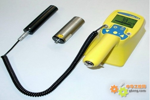

²úÆ·Ãû³Æ£º ±ãЯʽ±íÃæÕ´ÎÛÒÇ
ÐÍ ºÅ£º µÂ¹ú CoMo170
                        µÂ¹ú CoMo170±ãЯʽ±íÃæÕ´ÎÛÒÇ
¼ò½é
·CoMo170±íÃæÕ´ÎÛÒÇÊÇΪͬʱ²âÁ¿α¡¢β¡¢γ±íÃæÕ´ÎÛ¶øÉè¼Æ
·α£º0.1 cps£»β/γ15-25 cps
·¿ÉÒԹ̶¨»òÕßÒÆ¶¯Ê¹Óò¢Ö±½Ó»ò¼ä½Ó¼ì²â±íÃæÕ´ÎÛ£¨²ÁÊòâÊÔÑùÆ·£©
·´ËÒÇÆ÷Я´ø·½±ã£¬²Ù×÷¼òµ¥
·¹ã·ºÓ¦ÓÃÔÚ»·±£¡¢¹«°²¡¢¾ü¶Ó¡¢º£¹Ø¡¢ÎÀÉú¡¢ºË¹¤Òµ¡¢ºËµçÕ¾µÈϵͳ
ÌØµã
·ÐÂÐÍËÜÁÏÉÁ˸Ìå̽²âÆ÷£¬²»ÓÃ³äÆø
·¿Éͬʱ²âÁ¿αºÍβ/㣬ÎÞÐèÍâ¼Ó̽ͷ
·¾«¶È¸ß£¬¿É´æ750×é²âÁ¿Êý¾Ý²¢ÇÒ¿ÉÒÔ´«Êäµ½PCÉÏ
·β/γ±¾µ×¼à²âÓë²¹³¥£¬±¨¾¯ãÐÖµÁ¬Ðø¿ÉÉè
·25¸ö¿É×ÔÓɱ༭µÄºËËØ¿â£¬×Ô¶¯¿Û³ý±¾µ×
·²âÁ¿Ê±¼äºÍÕÕÃ÷ʱ¼ä¿Éµ÷
·´óÃæ»ýLEDÏÔʾ£¬ÔÚºÚ°µ»·¾³ÖпÉ×Ô¶¯¸ÐÓ¦²¢×Ô¶¯¿ªÆô±³¾°µÆ
·Ì½²âÃæ»ý´ó£ºCoMo170£º170cm2£»CoMo300£º300cm2
·Óû§ÓѺýçÃæ£¬Ö»Ðè5¼ü²Ù×÷£¬ÏÔʾµ¥Î»cps¡¢Bq»òBq/cm2
·ÖØÁ¿ÇᣬÃÜÂë±£»¤¸ß¼¶²Ëµ¥
·Ñ¡ÅäÈí¼þ¶ÁÈ¡²âÁ¿Êý¾Ý
·Ñ¡Åäǽ±Ú¹Ì¶¨×°ÖÿÉÓÃÓÚ¼ì²âÊÖ²¿Õ´ÎÛ
·Ñ¡Åä²ÁÊÃÅä¼þ¿É×÷Ϊ²ÁÊüì²â
·Ñ¡Å䵨±í²âÁ¿¸¨Öú×°ÖÿÉÓÃÓÚµØÃæ¼ì²â
·Ñ¡ÅäÍâ½Ó̽ͷ£¬È磺¼ÁÁ¿ÂÊ̽ͷ»òÕ߹ܵÀÎÛȾ²âÁ¿£¬×Ô¶¯Ê¶±ð̽ͷÀàÐÍ
·ÆäËû¿ÉÑ¡Åä¼þ£¨²âÊÔÔ´£¬±ãЯÏä……£©
¼¼Êõ²ÎÊý
·Ì½²âÆ÷ÀàÐÍ£ºZnSÍ¿²ã¡¢±¡Ä¤ËÜÁÏÉÁ˸Ìå̽²âÆ÷
·Ì½²âÆ÷³ß´ç£ºCoMo 170£º170cm2 £»
·±¨¾¯·½Ê½£ºÉù¹â±¨¾¯
·µ¥Î»£ºcps¡¢Bq»òBq/cm2£¬µ±Íâ½Ó¼ÁÁ¿ÂÊ̽ͷʱÏÔʾn/μ/mSv/h
·ºËËØ¿â£º25¸öºËËØ£¬²¢ÓÐÖØÐÂÉ趨£¬×Ô¶¯Ð£Õý¹¦ÄÜ
·±¾µ×¿Û³ý£º¿Û³ýºÍ²»¿Û³ý±¾µ×¿ÉÑ¡£¬±¾µ×²âÁ¿Ê±¼ä¿ÉÉè
·²âÁ¿Ê±¼äÉèÖãºÔڲ˵¥ÖпÉÑ¡Ôñ²âÁ¿Ê±¼äģʽ»òÕßÎó²îÂÊֵģʽ£¨½öÏ޹̶¨Ç½ÉÏ»òÕß²ÁÊòâÊÔʹÓã©£¬Ê±¼äµ¥Î»ÎªÃë
·ÖØÁ¿£ºCoMo 170 750g£¨°üº¬µç³Ø£©
·ÏÔʾ£º´ó³ß´çLCDÏÔʾ£¬128×64ÏñËØ£¬´ø±³¾°µÆ
·µçÔ´£º2½ÚAA 1.5V¼îÐÔµç³Ø»òNiMH³äµçµç³Ø¿É¹¤×÷25Сʱ
·Î¶ȣº-10¡æ¡«+40¡æ£¬±¸Ñ¡-20¡æ
·Íâ¿Ç£ºÈËÌ幤³ÌѧËÜÁÏÍâ¿Ç
·ÌØÊâÐͺţºCoMo 170FרΪÏû·ÀÔ±Éè¼ÆK/FW/IdF 110213 CoMo 170D ÔÚǰ¶Ë±íÃæÔö¼ÓGM¹Ü¼ÆÊýÆ÷
·ÒÇÆ÷³ß´ç£º280×125×135mm£¨L(º¬ÊÖ±ú)×W×H£©
·Ì½²âЧÂÊ£º£¨Ì½²âÃæ»ý100 cm2£©
