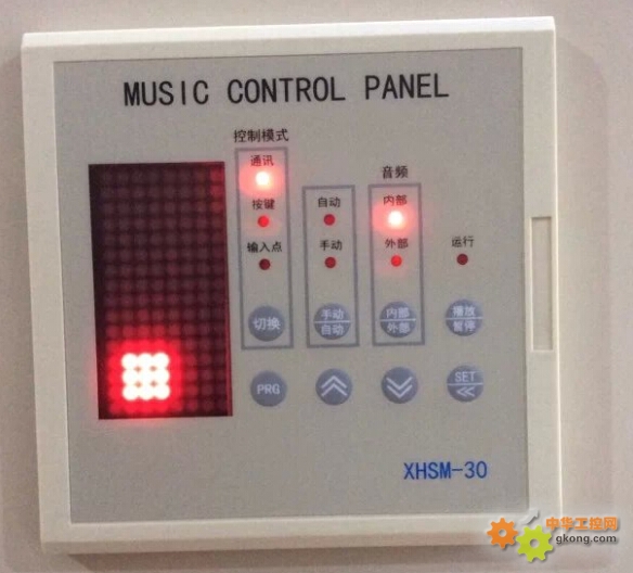

 Ê¹Óñ¾¿ØÖÆÆ÷Äܳä·Ö·¢»Ó±äƵµ÷ËÙÆ÷µÄÌØµã£¬ÎªÄúµÄÅçȪ¹¤³ÌÔö¹âÌí²Ê¡£Ëü¿É½«À´×Ô¹âÅÌ CD¡¢VCD¡¢DVDµÄÒôÀÖÐźÅ×Ô¶¯×ª»»³É±äƵµ÷ËÙÆ÷ËùÒªÇóµÄ¿ØÖÆÐźš£Êä³öÐźÅÓëÊäÈëµÄÒôÀÖÐźŴóС³ÉÏßÐÔ¹ØÏµ£¬Ê¹ÅçȪµÄÅç¸ßËæÒôÀÖÐźŴóС±ä»¯£¬ÒôÀÖ¡¢Ë®»¨¡¢²ÊµÆÈÚΪһÌ壬ÑݳöÒ»³¡½»Ïìˮʫ¡£
¸Ã¿ØÖÆÆ÷³ýÒÔÉϰÑÒôƵÐźÅת»¯ÎªÄ£ÄâÁ¿ÐźŠ£¬»¹¿ÉÒÔÔÚijµãÒôƵÐźÅʵÐпª¹ØÁ¿Êä³ö£¬ÁíÍ⻹´øÓÐÒôƵÆô¶¯Ðźš£ËùÒԸÿØÖÆÆ÷²»½öÄÜ¿ØÖÆ±äÆµÆ÷£¬¶øÇÒ»¹ÄÜ¿ØÖƹÌ̬¼ÌµçÆ÷¡£
ÌØµã£º×Ô¶¯¼ì²âÒôÀÖÇ¿¶ÈÐźż°ÒôÀÖ½Ú×àÐźţ¬XHYK-30ÐÍÒôÀÖ¿ØÖÆÆ÷×Ô´øÒôÀÖÎļþ´æ´¢¿ÉÒÔͨ¹ýXHSM-56A1ÅçȪ¿ØÖÆÖ÷»úÀ´ÊµÏÖ²¥·Å¸èÇú£¬Êä³öÒôƵÐźţ¬Í¬Ê±Êä³öÒôÀÖ½Ú×àÐźţ¨ÊÊÓùÌ̬¿ØÖÆÒô¿Ø£©£¬ºÍÄ£ÄâµçѹÐźſØÖÆË®ÖùË®Á¿ºÍ¸ß¶È±ä»¯¡£
ÒôÀÖÅçȪ¿ØÖÆÆ÷Ñ¡ÐÍ±í£º
ÐͺŠXHYK-10   XHYK-30
ÒôƵÊäÈëÐźŠÒôƵÐźŠ  ÒôƵÐźÅ
ÒôÀÖ´æ´¢ ÎÞ   ÓÐ
Ô¶³Ì²¥·Å ÎÞ   ÓÐ
Êä³öÐźŠ1·¼ÌµçÆ÷Êä³ö 3·¾§Ìå¹ÜÊä³ö 3·µçѹÐźÅÊä³ö   1·¼ÌµçÆ÷Êä³ö  3·¾§Ìå¹ÜÊä³ö  3·ģÄâÁ¿Êä³ö
ͨѶ¿Ú ÎÞ   ÓÐ
×Ô¶¯½Ú×àʶ±ð ÎÞ   ÓÐ
ÊÖ¶¯½Ú×àʶ±ð ÓÐ   ÎÞ
Ò»¡¢¹¦ÄܸÅÊö

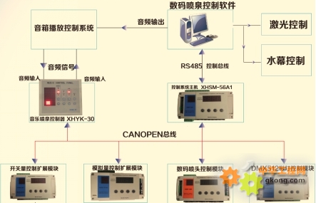

XHYK-30ΪÊýÂëÅçȪ¿ØÖÆÏµÍ³ÌṩÒôƵ²¥·Å¡¢Êý¾Ý²É¼¯¹¦ÄÜ£¬ÄÚ²¿¼¯³ÉMP3²¥·ÅÆ÷¡¢ÒôÀÖ¿ØÖÆ¡¢Í¨Ñ¶µÈÄ£¿é¡£×÷ΪÅçȪ¿ØÖÆÏµÍ³µÄÒôÀÖ¿ØÖÆÆ÷²¿·Ö¹¤×÷ʱ£¬ÊÜXHSM-56A1Ö÷»úÃüÁî¿ØÖÆ£¬²¥·ÅÖ¸¶¨Îļþ£¬²¢°´ÕÕÒôÀÖ½Ú×àÊä³ö¿ª¹ØÁ¿¡¢Ä£ÄâÁ¿Ðźš£ÈçЩͼËùʾ£º
¿ØÖÆÆ÷ͬʱ֧³ÖÍÑÀë56A1Ö÷»ú¶ÀÁ¢¹¤×÷,¿ÉÉèÖÃÔÚ°´¼ü¿ØÖÆ»òÔ¶³ÌÊäÈë¿ØÖÆ¡£
