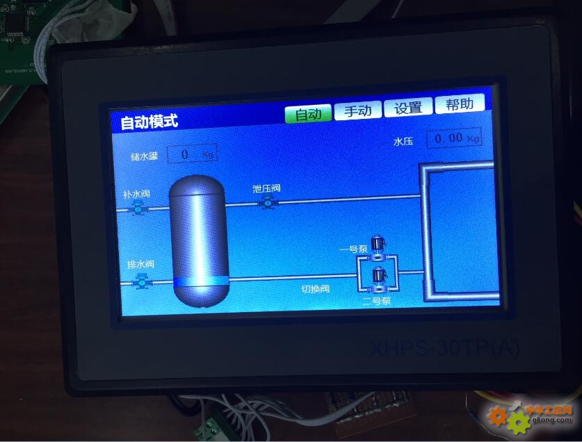

²úÆ·Ãû³Æ£º ¶¨Ñ¹²¹Ë®ÍÑÆø´¥ÃþÆÁÒ»Ìå»ú¿ØÖÆÆ÷
ÐÍ ºÅ£º XHPS-30TPA
Ò»¡¢¹¦ÄÜ˵Ã÷
1. ´¥ÃþÆÁÃæ°åÏÔʾ¹¤×÷״̬¡£
2. ÔÚÆÁÄ»ÉÏ¿ÉÒÔÉ趨¸÷Ïî²ÎÊý£¬²Ù×÷É豸¡£
4. ͨ¹ýÍÑÆø²¹Ë®Çл»·§¡¢ÍÑÆø²¹Ë®µç´Å·§Íê³ÉÕæ¿ÕÍÑÆø¹¦ÄÜ£¬Í¨¹ý²¹Ë®µç´Å·§¡¢Ð¹Ñ¹µç´Å·§¡¢ÅÅË®µç´Å·§¡¢³ÆÖرäËÍÆ÷(Һλ±äËÍÆ÷)Íê³É¶¨Ñ¹²¹Ë®¹¦ÄÜ£¬Á½Ì¨Ë®±Ã¿ÉÑ¡Ôñ¹¤×÷·½Ê½¡£
5. ÉèÓÐÊÖ¶¯¡¢×Ô¶¯¡¢Ô¶¿Ø3ÖÖ¹¤×÷·½Ê½
6. ¿ØÖÆÆ÷ÉèÓйÊÕÏÐźÅÊäÈë¡¢Êä³öµÈ¶àÖÖÐźŹ©Óû§Ñ¡ÔñʹÓá£
7. ´øÓÐ485ͨѶ½Ó¿Ú£¬²ÉÓÃMODBUS±ê׼ͨѶЭÒ飬¿ÉʵÏÖÔ¶³ÌͨѶ¹¦ÄÜ¡£
8. ÄÚÉ趨ʱͣ»ú¹¦ÄÜ£¬ÐèÊäÈëÃÜÂë½â³ý¡£
ËÄ¡¢¹¦ÄÜ˵Ã÷
³§¼ÒÉèÖõǼ½çÃæ
ÉèÖýçÃæµÄ×óÉϽÇÉèÖÃģʽµÄ×ÖÌå´¦µã»÷µ¯³öµÇ¼½çÃæ£¬ÊäÈë³§¼ÒÉèÖÃÃÜÂë¼´¿É½øÈë³§¼ÒÉèÖÃ
¼¤»î½çÃæ
ÉèÖýçÃæµÄ×óÉϽÇÉèÖÃģʽµÄ×ÖÌå´¦µã»÷µ¯³öµÇ¼½çÃæ£¬ÊäÈëÃÜÂë123456¼´¿É½øÈ뼤»î״̬½çÃæ£¬µã»÷¼¤»î״̬½øÈ뼤»îÀ¸£¬ÊäÈ뼤»îÃÜÂë¼´¿É¼¤»î
£¨Ò»£©¿ØÖƶÔÏó
¿ØÖÆÉ豸£ºÁ½Ì¨Ë®±Ã£¨»òһ̨ˮ±Ã£©¡¢Ëĸöµç´Å·§£¬Ò»¸öµç¶¯·§¡£
ÊäÈëÐźţºÒ»¸öѹÁ¦´«¸ÐÆ÷¡¢Ò»¸öҺλ´«¸ÐÆ÷£¨³ÆÖØ´«¸ÐÆ÷£©¡£
Á½Ì¨Ë®±Ã¿ÉʵÏÖһ̨ʹÓã¬Ò»Ì¨±¸Ó㬻òÕßÁ½Ì¨Í¬Ê±Ê¹Óá£
Һλ´«¸ÐÆ÷£¨³ÆÖØ´«¸ÐÆ÷ÏÔʾ¶¨Ñ¹¹ÞÀïË®º¬Á¿£©£¬Ñ¹Á¦´«¸ÐÆ÷ÏÔʾѹÁ¦´óС¡£
Ëĸöµç´Å·§·Ö±ðΪ ¢ÙÅÅË®µç´Å·§ ¢Ú²¹Ë®µç´Å·§ ¢Ûйѹµç´Å·§¢ÜÍÑÆø²¹Ë®µç´Å·§
£¨¶þ£©¶¨Ñ¹²¹Ë®¿ØÖÆÄ£Ê½
Ò»¡¢ÒºÎ»¿ØÖÆ
µ±ÒºÎ»´ïµ½Aµã£¨Èç×óͼ£©Ê±¢Ù²¹Ë®µç´Å·§¿ªÆô£¬Ë®Î»ÉÏÉý£¬´ïµ½Bµãʱ²¹Ë®µç´Å·§¹Ø±Õ£¬Ë®Î»´ïµ½Cµãʱ¢ÛÅÅË®µç´Å·§¿ªÆô£¬Ë®Î»Ï½µÖÁBµãʱÅÅË®µç´Å·§¹Ø±Õ¡£
¶þ¡¢Ñ¹Á¦¿ØÖÆ
ѹÁ¦´«¸ÐÆ÷²âµÃϵͳѹÁ¦ÎªÒ»¶¨·¶Î§ÄÚ£¨Èç×óͼ£©£¬¼´D-E·¶Î§£¬Ë®±Ã²»¿ªÆô£¬µ±Ñ¹Á¦µÍÓÚDµãʱ£¬Ë®±ÃÆô¶¯£¬Ñ¹Á¦´ïµ½Eµãʱˮ±ÃÍ£Ö¹¡£µ±Ë®Ñ¹´ïµ½Fµãʱ¢Úйѹµç´Å·§´ò¿ªÐ¹Ñ¹£¬Ñ¹Á¦½µÖÁEµãʱйѹµç´Å·§¹Ø±Õ¡£
