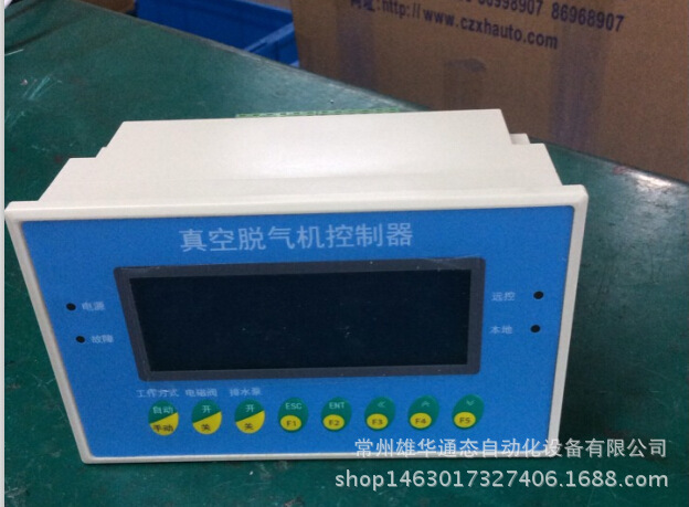

²úÆ·Ãû³Æ£º Õæ¿ÕÍÑÆø»ú¿ØÖÆÆ÷
ÐÍ ºÅ£º XHZK-10
Ò»¡¢ ¹¦ÄÜ˵Ã÷
1¡¢ Òº¾§Ãæ°åÏÔʾ¹¤×÷״̬¡¢Ê±ÖÓʱ¼ä¡£
2¡¢ ÏÔʾ¹«Ë¾ÁªÏµµç»°¡£
3¡¢ ÔÚÃæ°åÉÏ¿ÉÒÔÉ趨¸÷Ïî²ÎÊý£¬²Ù×÷É豸¡£

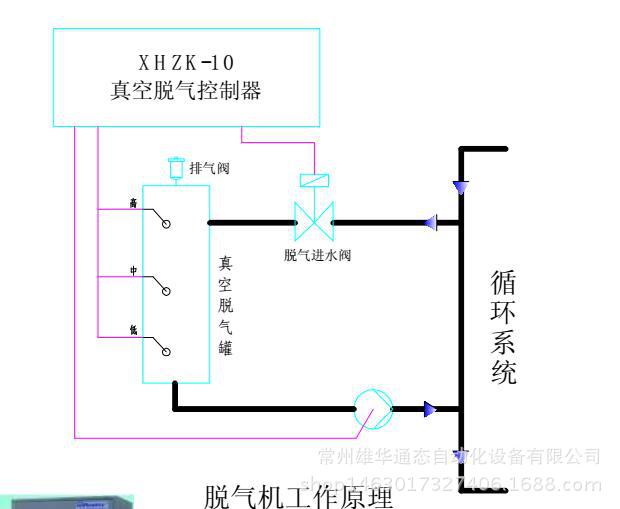

4¡¢ ÅÅÆø·½Ê½ÓÐҺλºÍʱ¼äÁ½ÖÖ£¬ÒºÎ»·½Ê½ÖÐÉèÓиßÖеÍÈý¸öҺλ¿ØÖÆÐźÅÊäÈë¶Ë£¬¿ØÖƽøË®µç´Å·§ºÍÅÅË®±Ã¡£ÅÅË®±Ã³ýÁ˵ÍҺλÐźŶ˿ªÊ±Í£Ö¹¹¤×÷£¬ÆäËûλÖÃÐźŽÓͨʱ¾ù´¦ÓÚ¹¤×÷״̬£»½øË®µç´Å·§ÔÚÖÐҺλÐźŶ˿ªÊ±¿ªÊ¼¹¤×÷£¬µ½¸ßҺλÐźŽÓͨʱֹͣ¹¤×÷¡£
5¡¢ É豸×Ô¶¯¹¤×÷ʱÉèÓж¨Ê±¡¢Ô¶¿ØÁ½ÖÖ¹¤×÷·½Ê½
6¡¢ ¿ØÖÆÆ÷ÉèÓйÊÕÏÐźÅÊäÈë¡¢Êä³öµÈ¶àÖÖÐźŹ©Óû§Ñ¡ÔñʹÓá£
Õæ¿ÕÍÑÆø»ú¿ØÖÆÆ÷
Ãæ°å²¼ÖÃͼ½éÉÜ
1¡¢ Ãæ°åÉèÓеçÔ´¡¢¹ÊÕÏ¡¢Ô¶¿Ø¡¢¾ÍµØ4¸öָʾµÆ¡£
2¡¢ Òº¾§Ãæ°åÄÚÏÔʾµ±Ç°Ê±¼äºÍ¹¤×÷״̬¡£
3¡¢ “¹¤×÷·½Ê½”¼ü£ºÑ¡Ôñ ×Ô¶¯/ÊÖ¶¯Ä£Ê½£¬ÊÖ¶¯Ä£Ê½£º¿ÉÒÔÔÚÃæ°åÉÏÖ±½Ó²Ù×÷“µç´Å·§”ºÍ“ÅÅË®±Ã”¿ªºÍ¹Ø¡£×Ô¶¯Ä£Ê½£º¿ÉÒÔ°´ÕÕÉ趨ʱ¼ä»òÔ¶µØ¿ØÖÆÉ豸¿ªºÍ¹Ø¡£
4¡¢ “ESC”£¨F1£©¼ü£º½øÈëÖ÷²Ëµ¥Ò³Ãæ¡¢²ÎÊýÉ趨¡£
5¡¢ “ENT”£¨F2£©¼ü£ºÔÚÖ÷²Ëµ¥Ò³ÃæÊ±½øÈë¹ÊÕϲéѯ¡£ÔÚ²ÎÊýÉ趨״̬ʱ£º½øÈë»ò±£´æÍ˳ö²ÎÊýÐ޸ġ£
6¡¢ “¡¶/F3”¼ü £ºÔÚÖ÷²Ëµ¥Ò³ÃæÊ±½øÈë°ïÖúÐÅÏ¢²éѯ£»ÔÚ²ÎÊýÉ趨״̬ʱÏò×óÒÆÎ»É趨ֵ ¡£
7¡¢ “^\F4”¼ü£ºÔÚÖ÷²Ëµ¥Ò³ÃæÊ±·µ»Ø¹¤×÷×´Ì¬Ò³Ãæ£»ÔÚ²ÎÊýÉ趨״̬ʱÔö´óÉ趨ֵ ¡£
8¡¢   “V\F5”¼ü£ºÔÚ²ÎÊýÉ趨״̬ʱÏò¼õСÉ趨ֵ ¡£
