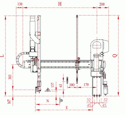

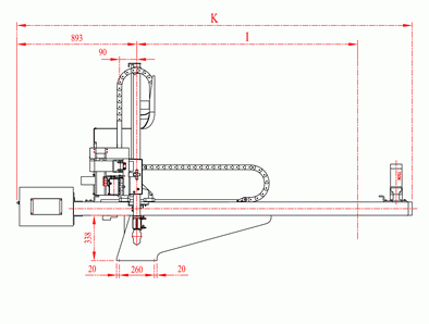

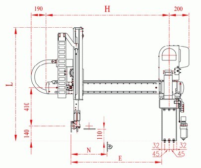

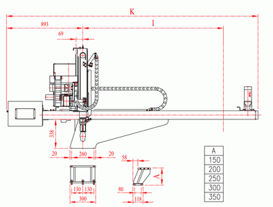

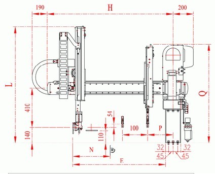

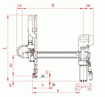

==Mechanical Drawings==
Model No.
E
H
I
K
L
N

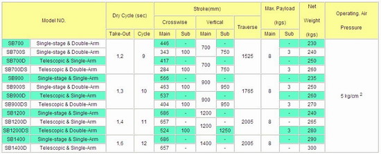

SB700
669
1000
1525
2941
1519
446
SB900
789
1120
1765
3181
1719
566
SB1200
909
1240
2005
3421
2019
686
SB1400
909
1240
2005
3421
2219
686
Model No.
E
H
I
K
L
N
Q
SB700S
746
1000
1525
2941
1519
343
1510
SB900S
789
1120
1765
3181
1719
463
1710
Model No.
E
H
I
K
L
N
SB700D
676
1000
1525
2941
1200
417
SB900D
796
1120
1765
3181
1300
537
SB1200D
916
1240
2005
3421
1450
657
SB1400D
916
1240
2005
3421
1550
657

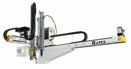

==Technical Specifications==
Power Source:AC 220V SINGLE PHASE
Positive servomotor drives with
rack and pinion gear
on vertical arm.
  Hand-Held Controller :
One key one-function designs for clearly commanded.
Pulse generator can manually move the robot to designate location, save and easy for programming. Multi-language switches and conversational method guides the operator through out user-friendly operation.
Each teachable program can write up to 100 steps, each step can write 10 motion sequences together.
All speeds can be adjusted by the percentage rate.
Application :
14 spare input and 12 Spare output terminal for coordinate with other auxiliary equipments.
Parts Removal :
a) Reduce the difficulty and lower the cost to built End Of The Arm Tooling.
b) Able to reach unconventional paths such as curves, hooks, undercut, exceptional route.
Stack and array :
In one cycle can handle up to 9 stack areas with individual stacking format. Otherwise can place 100 points on a same working surface.
Insert and grid :
In one cycle can pick 9 different ion materials into the mold. It can be feed from a single point or grid pallet or multi-station.
Inspection :
a) Reject program: When detecting the reject signal from Injection Molding Machine, it can set the quantities and place on a different area.
b) Inspection program: By setting the quality counter for Q/C purpose. For example to inspect the parts every 100 molding cycle once.
c) Test-Mold program: By setting the test-mold counter, at the beginning of the automatic molding cycle can be checked.
d) Weight program: Check the quality parts by electronic weight scale. It can separate the defects.
e) Cycle counter: By setting the total molding cycle. It only counting the good parts, inspection and defects will not taken into total count.
