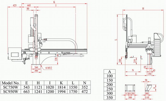

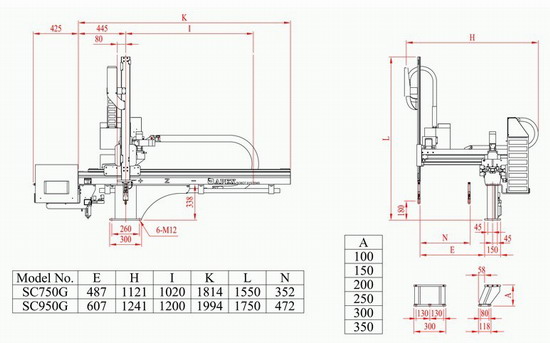

==Mechanical Drawings==

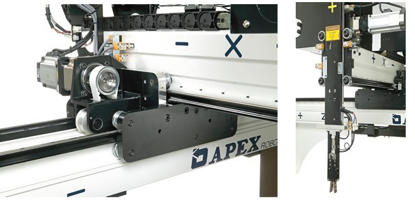

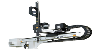

AXIS SERVO DRIVEN CNC ROBOT :
a) Light weight high speeds model for modern electrical injection molding machine.
b) 3 axis CNC servomotor driven. Free tracking programming with pulse generator.
c) Window XP base DSP control system with USB port. Easy to upload / download programs.
d) All the necessary functions built in as standard. No extra charge.
e) Able to storage teach program download or upload to PC through USB port.

• All moving axis rides on harden tool steel rail with bearing  guide.
• Less friction quiet smooth movement ideal for  high speeds  application.
• Alloy aluminum extrusion arm.
• Thin wall design for tight mold space and high   speeds take-out.
Equipped with AC brushless servomotors and individual control. 3 Axes can be synchronized move to designate point at the same time. Accuracy within + / - 0.1mm
