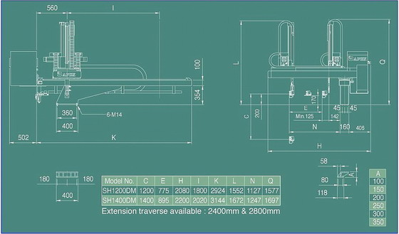

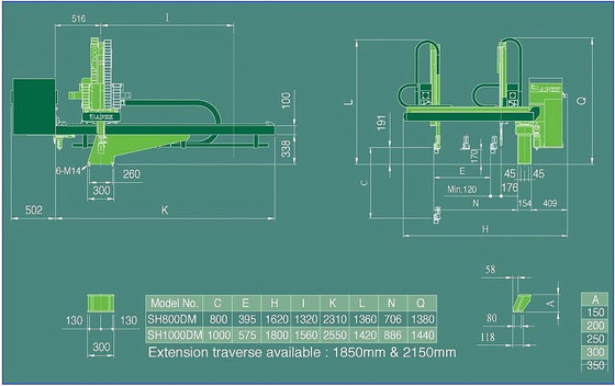

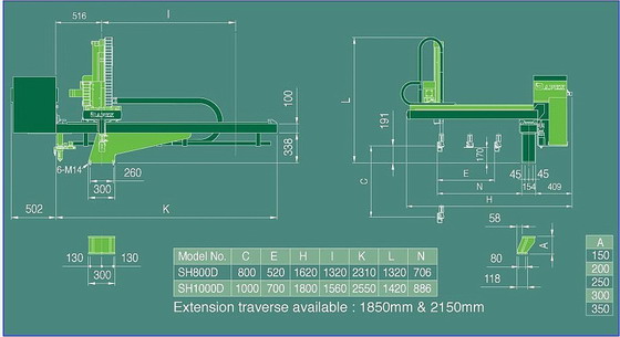

==Mechanical Drawings==
SH800D ~ SH1000D
SH800DM ~ SH1000DM

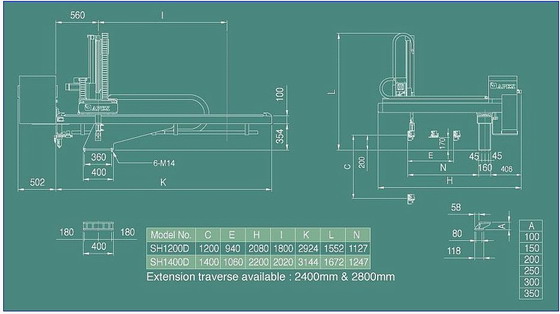

SH1200D ~ SH1400D
SH1200DM~ SH1400DM

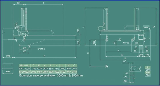

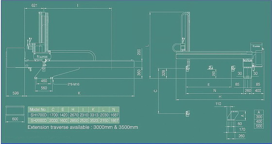

SH1700D ~SH2000D
SH1700DM ~SH2000DM

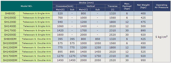

==Technical Specifications==
Operation Voltage:AC 220V 3 phase
6 AXIS SERVOMOTOR DRIVEN CNC ROBOTS WITH TELESCOPIC ARM
  • Rigid box frame design on the cross axis. Very sturdy under high speeds
    operation.
  • Strong and lightweight Aluminum alloy extrusion material that can absorb
    shock wave further more to reduce vibration.
  • 6 axis synchronized movement. Free tracking control with pulse generator,
    easy to program.
  • Sub-arm model equipped with electrical motor for easy strokes adjustment.
    No need to climb up.
