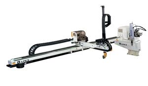

3 AXES SERVO DRIVEN CNC ROBOT
PARALLEL FORWARD LOADER TYPE

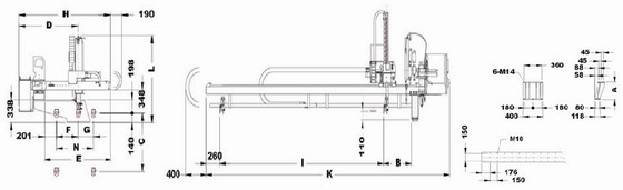

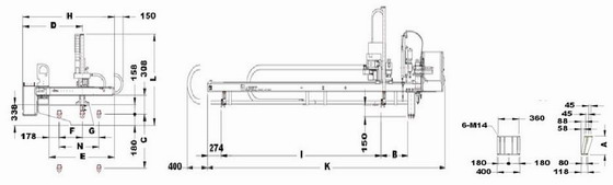

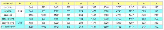

==Mechanical Drawings==
SE700~SE1200
SE700D~SE1200D

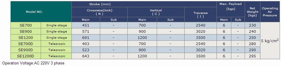

==Technical Specifications==
Hand-Held Pendent
    One key one-function designs for clearly commanded. Pulse generator can manually move the robot to designate location, safe and easy for programming. Multi-language switches and conversational method guides the operator through out user-friendly operation.
    Each teachable program can write up to 500 steps, each step can write 10 motion sequences together. All speeds can be adjusted by the percentage rate.
