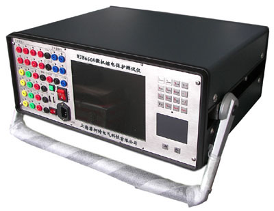

ÐÍ ºÅ£º WJB660A
WJB660A΢»ú¼Ìµç±£»¤²âÊÔÒÇ
ÉϺ£·Æ¿ÂÌØµçÆø¿Æ¼¼ÓÐÏÞ¹«Ë¾ÊÇÉϺ£µçÁ¦¿Æ¼¼Ô°¸ßÐÂÆóÒµ¡£±¾Ä¿Â¼ÊÇÉϺ£·Æ¿ÂÌØµçÆø¿Æ¼¼ÓÐÏÞ¹«Ë¾ÎªÄú¾«Ñ¡µÄWJB660A΢»ú¼Ìµç±£»¤²âÊÔÒDzúÆ·£¬»¶Ó­ÄúÀ´µç×Éѯ¸Ã²úÆ·µÄÏêϸÐÅÏ¢£¡WJB660A΢»ú¼Ìµç±£»¤²âÊÔÒǵÄÖÖÀàÓкܶ࣬²»Í¬µÄÓ¦ÓÃÒ²»áÓÐϸ΢µÄ²î±ð£¬±¾¹«Ë¾ÎªÄúÌṩȫ·½Î»µÄ½â¾ö·½°¸¡£
ÐÔÄÜÌØµã£º
1¡¢ÁùÏàµçÁ÷£¬ÁùÏàµçѹͬʱÊä³ö£¬µçÁ÷£º30A/Ï࣬µçѹ£º125V/Ïà
2¡¢Ö÷¿Ø°å²ÉÓÃDSP+FPGA½á¹¹£¬16λDACÊä³ö£¬¶Ô»ù²¨¿É²úÉúÿÖÜ2000µãµÄ¸ßÃܶÈÕýÏÒ²¨£¬Îª¹úÄÚ²âÊÔÒÇÖеÄ×î¸ßˮƽ£¬´ó´ó¸ÄÉÆÁ˲¨ÐÎÖÊÁ¿£¬Ìá¸ßÁ˲âÊÔÒǵľ«¶È¡£
3¡¢µ¥»ú¶ÀÁ¢ÔËÐУ¬ÄÚÖøßÐÔÄܹ¤¿Ø»ú£¬×¡Æµ300~600MHZ£¬128MÄڴ棬12GÓ²ÅÌ£¬ÔËÐÐWindows Xp²Ù×÷ϵͳ£¬Ãæ°åÅäÓи߼¶²»Ðâ¸Ö¼üÅÌ£¬¹ì¼£ÇòÊó±ê8.4´çTFTÕæ²ÊÒº¾§ÏÔʾÆ÷¡£
4¡¢²ÉÓÃUSB2.0½Ó¿ÚÓëµçÄÔÏàÁ¬£¬ÎÞÐëÈκÎת½ÓÏߣ¬Ê¹Ó÷½±ã¡£

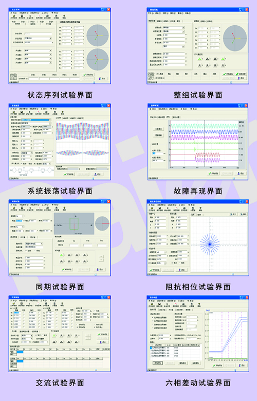

5¡¢¿É¶ÔÏÖ³¡¸÷Ö̵ּçÆ÷£¬±£»¤¼°°²È«×Ô¶¯×°ÖýøÐж¨¼ì£¬²¢¿ÉÄ£Äâ¸÷ÖÖ¸´ÔÓ˲ʱÐÔ£¬ÓÀ¾ÃÐÔ£¬×ª»»ÐÔ¹ÊÕϽøÐÐÕû×éÊÔÑé¡£¿Éʵʱ±£´æ²âÊÔÊý¾Ý£¬ÏÔʾʸÁ¿Í¼£¬»æÖƸ÷ÖÖÌØÐÔÇúÏߣ¬Áª»ú´òÓ¡±¨±íµÈ¡£
6¡¢ÓÉÓÚÊÇÁùÏàµçÁ÷£¬ÁùÏàµçѹÊä³ö£¬¿É·½±ã¶Ô±¸×ÔͶװÉèÖúÍ΢»ú²î¶¯±£»¤×°ÖýøÐÐÊÔÑ飬ʹ¸ÃÏîÊÔÑé·Ç³£ÍêÃÀ¡£
7¡¢¿ÉÁ¬½Ó±Ê¼Ç±¾µçÄÔÔËÐУ¬±Ê¼Ç±¾µçÄÔÓ빤¿Ø»úʹÓÃͬһÌײâÊÔÈí¼þ£¬Ê¹Ó÷½±ã¡£
