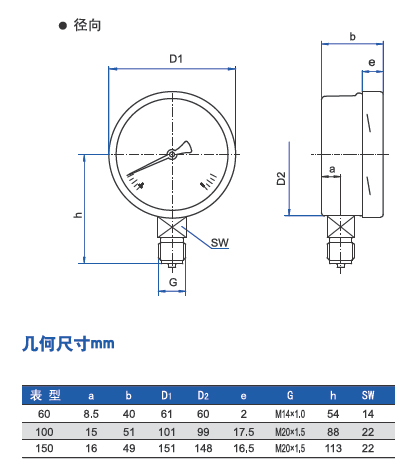

    4¡¢ÍâÐγߴç

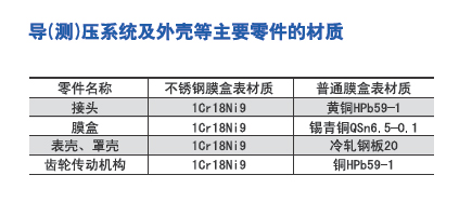

    5¡¢µ¼£¨²â£©Ñ¹ÏµÍ³¼°Íâ¿ÇµÈÖ÷ÒªÁã¼þµÄ²ÄÖÊ
