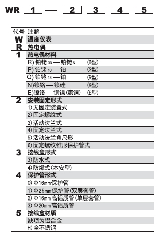

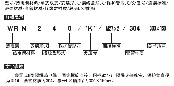

3¡¢Ðͺűíʾ

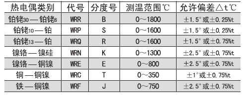

    ζȲâÁ¿·¶Î§ºÍÔʲî

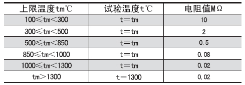

    Èȵçż¾øÔµµç×裨³£Î£©£º³£Î¾øÔµµç×èµÄʵÑéµçѹΪֱÁ÷500V¡À50V£¬²âÁ¿³£Î¾øÔµµç×èµÄ´óÆøÌõ¼þΪζÈ15¡«35¡æ£¬Ïà¶Ôʪ¶È45%¡«75%£¬´óÆøÑ¹Á¦86¡«106KPa¡£
    £¨1£©¶ÔÓÚ³¤¶È³¬¹ý1Ã×µÄÈȵçż£¬ËüµÄ³£Î¾øÔµµç×èÖµÓëÆä³¤¶ÈµÄ³Ë»ýÓ¦Äɲ»´óÓÚ100M¦¸.m  ¼´£ºRr¡ÁL¡Ý100M¦¸.m  L>m¡£
    £¨2£©¶ÔÓÚ³¤¶È¶ÅÓî»ò²»×ã1Ã×µÄÈȵçż£¬ËüµÄ³£Î¾øÔµµç×èÖµÓ¦²»Ð¡ÓÚ100M¦¸
    Èȵçż¾øÔµµç×裨³£Î£©
