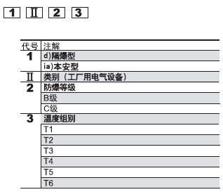

4¡¢·À±¬±êÖ¾¡¢Àà±ð¡¢¼¶±ðºÍζÈ×é±ð
    µçÆøÉ豸µÄÀà±ðºÍζÈ×é±ð˵Ã÷
    µçÆøÉ豸·ÖΪ¶þÀà
    ¢ñÀࡪ¡ªÃº¿ó¾®ÏÂÓÃµçÆøÉ豸
    ¢òÀࡪ¡ª¹¤³§ÓÃµçÆøÉ豸

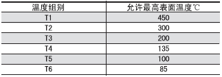

    ζÈ×é±ð£º·À±¬ÐÍ¡¢±¾°²ÐÍÈȵçżµÄζÈ×é±ð°´ÆäÍâ¶²¿·Ö×î¸ß±íÏÖζȷÖΪT1¡«T6Áù×é
