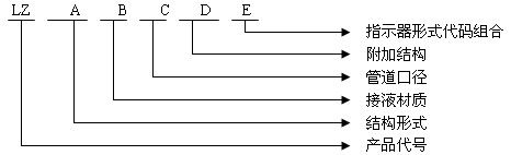

ËÄ.Ñ¡ÐÍÖ¸ÄÏ
²âÁ¿¹Ü½á¹¹A
½ÓÒº²ÄÖÊB
¹ÜµÀ¿Ú¾¶C
¸½¼Ó½á¹¹D
10
ÏÂ
½ø
ÉÏ
³ö
R0
R1
RP
Ti
RL
Ocr18Ni12Mo2Ti
1Gr18Ni9Ti
PTFE
îѺϽð
316L
DN15
DN25
DN50
DN80
DN100
DN150
DN200
ÎÞ
T
Z
G
Y
¼ÐÌ×ÐÍ
×èÄáÐÍ
¸ßÎÂÐÍ
¸ßѹÐÍ
11
ÏÂ
½ø
²à³ö
R0
R1
RL
Ocr18Ni12mo2Ti
1Gr18Ni9Ti
316L
DN15
DN25
DN50
DN80
DN100
DN150
DN200
ÎÞ
Z
G
Y
×èÄáÐÍ
¸ßÎÂÐÍ
¸ßѹÐÍ
52
²à
½ø
²à³ö
R0
R1
RL
Ocr18Ni12mo2Ti
1Gr18Ni9Ti
316L
DN15
DN25
DN50
DN80
DN100
DN150
DN200
ÎÞ
Z
G
Y
×èÄáÐÍ
¸ßÎÂÐÍ
¸ßѹÐÍ
13(ÓÒ½ø×ó³ö)
14(×ó½øÓÒ³ö)
R0
R1
RL
Ocr18Ni12mo2Ti
1Gr18Ni9Ti
316L
DN15
DN25
DN50
DN80
DN100
DN150
DN200
ÎÞ
Z
G
Y
×èÄáÐÍ
¸ßÎÂÐÍ
¸ßѹÐÍ
ָʾÆ÷ÐÎʽ´úÂë×éºÏ
E     Ö¸Ê¾Æ÷ÐÎʽ´úÂë×éºÏ(¶ÔÓÚÔ¶´«4-20mA±ê×¼µçÁ÷ÐÍָʾÆ÷£¬¿ÉÑ¡ÔñHARTЭÒé)
ÎÞ
¾ÍµØÖ¸Ê¾Æ÷£¬»úеָÕëָʾ˲ʱÁ÷Á¿¡£
A
24V¹©µç£¬»úеָÕëָʾ˲ʱÁ÷Á¿£¬  Ô¶´«4-20mA±ê×¼µçÁ÷
B
24V¹©µç£¬Òº¾§ÏÔʾ˲ʱ/ÀÛ»ýÁ÷Á¿£¬  Ô¶´«4-20mA±ê×¼µçÁ÷
C
µç³Ø¹©µç£¬ÎÞÐźÅÊä³ö
D
220V¹©µç£¬Òº¾§ÏÔʾ˲ʱ/ÀÛ»ýÁ÷Á¿£¬Ô¶´«4-20mA±ê×¼µçÁ÷
·À±¬±êÖ¾
ÎÞ
ÆÕͨ²»·À±¬
I
±¾°²ÐÍ   ·½ÐÍ¿ÇÌå
d
·À±¬ÐÍ
±¨¾¯
ÎÞ
ÎÞ±¨¾¯
K1
ÉÏÏÞ±¨¾¯
K2
ÏÂÏÞ±¨¾¯
K3
ÉÏ¡¢ÏÂÏÞ±¨¾¯
