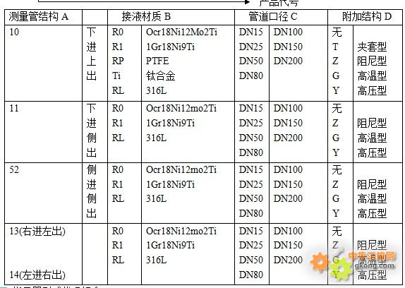

Èý¡¢¼¼Êõ²ÎÊý
1. Á¿³Ì±È£º±ê×¼ÐÍ£º10©s1  £¬ ¾«  ¶È£º±ê×¼ÐÍ1.5¼¶
2. Ñ¹Á¦µÈ¼¶£º±ê×¼ÐÍ£ºDN15-DN50  4.0MPa   DN80-DN200  1.6MPa
3. ½éÖÊζȣº±ê×¼ÐÍ£º-80¡æ¡«+200¡æ    ·À¸¯ÐÍ: 0¡æ¡«85¡æ
    4. ½éÖÊð¤¶È£ºDN15: ¦Ç<5mPa.S     DN25-DN150:  ¦Ç<2500mPa.S
5. »·¾³Î¶ȣº -25¡æ¡«+60¡æ
6. Á¬½ÓÐÎÊÆ£º  ±ê×¼·¨À¼»òÂÝÎÆ£¬µçÀ½ӿڣºM20¡Á1.5
7. ¹©µçµçÔ´£º±ê×¼ÐÍ£º24VDC¹©µç£¬µç³ØÐÍ£º3.6VÄøÇâµç³Ø
8. ±¨¾¯Êä³ö£ºÉÏÏÞ»òÏÂÏÞ˲ʱÁ÷Á¿±¨¾¯
9. ·À»¤µÈ¼¶£ºIP65£¬·À±¬±êÖ¾£º±¾°²ÐÍia¢òCT5    ¸ô±¬ÐÍd¢òCT5
