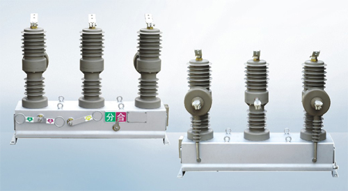

»§Íâ¸ßÑ¹Õæ¿Õ¶Ï·Æ÷
¸ÅÊö

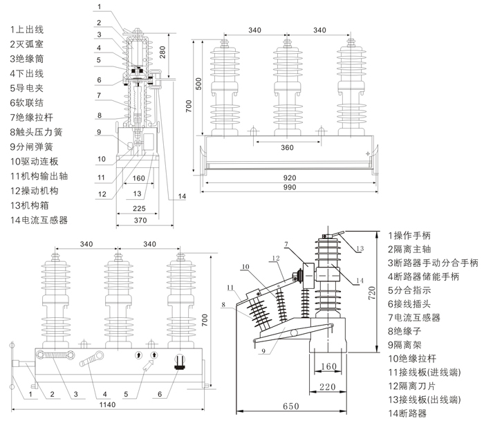

ZW32-12ϵÁл§Íâ½»Á÷¸ßÑ¹Õæ¿Õ¶Ï·Æ÷(ÒÔϼò³Æ¶Ï·Æ÷)Ϊ¶î¶¨µçѹ12KV¡¢ÈýÏཻÁ÷50HzµÄ»§ÍâÅäµçÉ豸¡£Ö÷ÒªÓÃÓÚ¿ª¶Ï¡¢¹ØºÏµç×ÓϵͳÖеĸººÉµçÁ÷¡¢¹ýÔØµçÁ÷¼°¶Ì·µçÁ÷¡£ÊÊÓÃÓÚ±äµçÕ¾¼°¹¤¿óÆóÒµÅäµçϵͳÖÐ×÷±£»¤ºÍ¿ØÖÆÖ®Ó㬼°Å©´åµçÍøÆµ·±²Ù×÷³¡Ëù¡£Ò²¿É×÷ΪµçÍøµÄ·Ö¶Î¿ª¹Ø£¬¼Ó×°¿ØÖÆÆ÷ºó£¬¿ÉʵÏÖÅäÍø×Ô¶¯»¯¡£

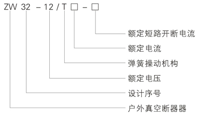

Ðͺż°Æäº¬Òå
Ö÷Òª¼¼Êõ²ÎÊý
ÐòºÅ ÏîÄ¿ µ¥Î» ²ÎÊý
1 ¶î¶¨µçѹ kV 12
2 ¶î¶¨ÆµÂÊ Hz 50
3 ¶î¶¨µçÁ÷ A 630
4 ¶î¶¨¶Ì·¿ª¶ÏµçÁ÷ kA 20
5 ¶î¶¨·åÖµÄÍÊܵçÁ÷(·åÖµ) kA 50
6 ¶î¶¨¶ÌʱÄÍÊܵçÁ÷ kA 20
7 ¶î¶¨¶Ì·¹ØºÏµçÁ÷(·åÖµ) kA 50
8 »úеÊÙÃü ´Î 10000
9 ¶î¶¨¶Ì·¿ª¶ÏµçÁ÷¿ª¶Ï´ÎÊý ´Î 30
10 ¹¤ÆµÄÍÊܵçѹ(1min);(ʪ)(¸É)Ïàͬ¡¢¶ÔµØ/¶Ï¿Ú kV 42/48
11 À×µç³å»÷ÄÍÊܵçѹ(·åÖµ)Ïàͬ¡¢¶ÔµØ/¶Ï¿Ú kV 75/85
12 ¶þ´Î»ØÂ·1min¹¤ÆµÄÍѹ kV 2
