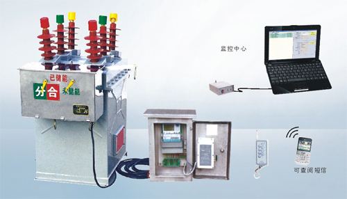

±¾²úÆ·ÊÊÓý»Á÷50HZ¡¢6-10KVÈýÏàµçÁ¦ÏµÍ³×öÔ¤¸¶·Ñ¸ßѹµçÁ¦¼ÆÁ¿¼°¹ýµçÁ÷±£»¤ºÍ¸º¿ØÊ¹Óá£
²úÆ·×é¹¹ÓÉÕæ¿Õ¶Ï·Æ÷¡¢¸ÉʽµçÁ÷¡¢µçѹ×éºÏ»¥¸ÐÆ÷£¬µçÄÜ±í¼ÆºÍ¿ØÖÆÏäÒÔ¼°GSMÖÕ¶Ë×éºÏÍê³É¡£µçÄÜ±í¼ÆºÍ¿ØÖÆÏäÓëÕæ¿Õ¶Ï·Æ÷×éºÏ»¥¸ÐÆ÷·ÖÌå°²×°£¬Í¨¹ý½ðÊôîø×°µçÀÂÏßÁ¬½Ó¡£µçѹ»¥¸ÐÆ÷²ÉÓÃV/V½Ó·¨£¬µçÁ÷»¥¸ÐÆ÷¿ÉÖÆ³É±ä±È·¶Î§5-600/5A¡£×éºÏ»¥¸ÐÆ÷Ϊȫ·â±Õ°²×°ÎÞÍâ¶¶þ´Î¶Ë×Ó£¬µç±íÏä×éºÏ¾ßÓзÀÇÔ¹¦ÄÜ¡£
Ô¶³Ì¿ØÖÆ×°ÖÃÀûÓÃÒÆ¶¯µÄGSMÍ¨Ñ¶ÍøÂç(º¯SIM¿¨)ͨ¹ýÊÖ»ú¶ÌÐŵÄÎÞÏߵ紫Ê䷽ʽ£¬Íê³ÉÔ¤¸¶·ÑºÍ¸º¿Ø¹¤×÷³ÌÐò¡£¿ÉÓÃÓÚµçÁ¦ÆóÒµµçÁ¦Ïß·¼ÆÁ¿·ÖÏß¿¼ºË£¬Óû§µçÁ¦¼ÆÁ¿£¬¿ÉʵÏÖµç·Ñ»ØÊÕ°´Ê±Èë¿â£¬ÊǼÓÇ¿ÓÃµç¿ÆÑ§¹ÜÀíµÄÒ»ÖÖÐÐÖ®ÓÐЧ´ëÊ©£¬ÊµÏÖÔ¶³ÌÔ¤¸¶·Ñ¿ØÖÆ¡£²úÆ·½á¹¹ºÏÀí£¬¿É¿¿ÐԸߣ¬Ìå»ý£¬Ð¡ÖØÁ¿Çᣬ±ãÓÚ°²×°£¬ÊÇIC¿¨Ô¤¸¶·ÑµÄÉý¼¶»»´ú²úÆ·¡£

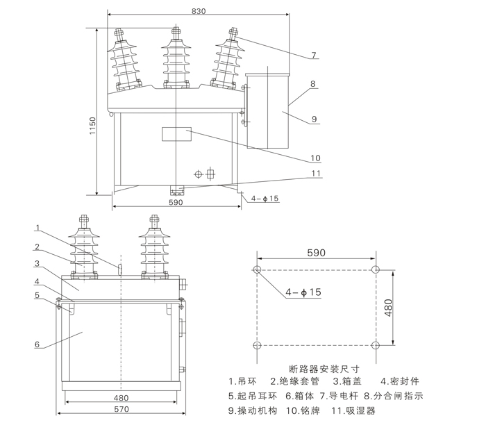

¿ØÖÆ×°Öð²×°Ê¾Òâͼ
