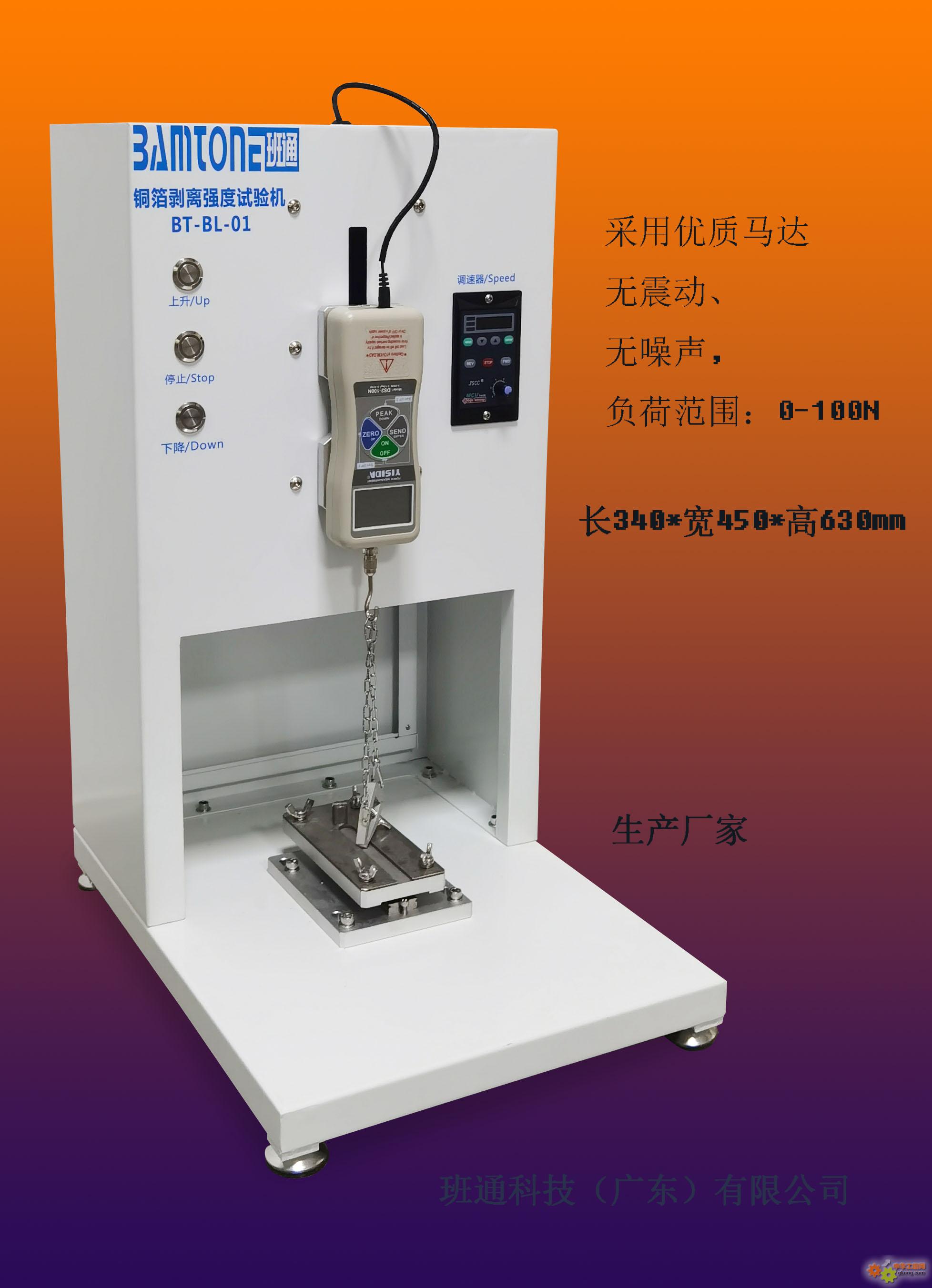

²úÆ·Ãû³Æ£º °àͨ¿Æ¼¼°þÀëÇ¿¶È²âÊÔÒÇ Bamtone/Peel-01
ÐÍ ºÅ£º Bamtone/Peel-01
²úÆ·¹¦ÄÜ
°þÀëÇ¿¶È²âÊÔÒÇ£¬Ö÷ÒªÓÃÓÚ½øÐвÄÁϵÄÀ­Éì¡¢°þÀë¡¢±äÐΡ¢ËºÁÑ¡¢ÈÈ·â¡¢Õ³ºÏ¡¢´©´ÌÁ¦¡¢¿ªÆôÁ¦¡¢µÍËÙ½â¾íÁ¦µÈÐÔÄܲâÊÔ¡£
Ó¦Ó÷¶Î§
PCBÐÐÒµÓ¦Ó㺸²Í­°å¡¢Ó¡ÖƵç·°åÐÐÒµÓÃÓÚ²âÁ¿¸ÕÐÔ/ÈÆÐÔ¸²Í­°åÉϵÄÍ­²­¿¹°þÀëÇ¿¶È¡£
²úÆ·ÌØµã
1¡¢²ÉÓÃÓÅÖÊÂí´ï¼°Ï߸˴«¶¯¡¢ÎÞÕ𶯡¢ÎÞÔëÉù,¸ººÉ·¶Î§£º0-100N(¿É¸ù¾ÝÒªÇó¶©ÖÆ)¡£
2¡¢´øÏÔµ÷ËÙÆ÷¡¢¿É¿ØÖÆÆä²âÊÔËÙ¶È£¬¾«¶È0.01N¡£
3¡¢²ÉÓÃÊýÏÔ¾«ÃÜÀ­Á¦±íÍ·£¬ÅäÓдòÓ¡¶Ë¿Ú£¬ÅäµçÄԿɼǼÁ¦µÄÇúÏßͼ»òÊý¾ÝºÏIEC-326-2¡¶Ó¡ÖƵç·°å4¡¢²âÊÔ·½·¨¡·7.1±ê×¼·ûºÏGB/T 4677-2002 7.1.1£¬GB/T13557-921PC-TM-650 2.4.8,IPC-TM-6502.4.9±ê×¼¡£
5¡¢Á¦±íÏÔʾµ¥Î»¿ÉÔÚ°õ¡¢¹«½ïºÍÅ£¶ÙÖ®¼äת»»£¬Á¦±íÄÚÖÿɳäµçµç³Ø¡£
6¡¢¾ßÓÐN¡¢kg¡¢lbÈýÖÖµ¥Î»×ÔÓÉת»»
7¡¢ËÄλ°ëÒº¾§Êý×ÖÏÔʾ²ÉÓÃUSBÊý¾ÝÁ¬½ÓÏߣ¬¿ÉÓëµçÄÔÁª½ÓʹÓã¬Ê¹ÓÃÈí¼þ½øÐÐͳ¼Æ·ÖÎö¼°À­Á¦Í¼±í¼´Ê±ÏÔʾ¡£
¼¼ÊõÖ¸±êºÍ²ÎÊý
ÐͺÅ
Bamtone/Peel-01
¸ººÉ·¶Î§
0¡«100N
¾«¶È
¾«¶È£º0.01N
×î´óÐгÌ
100mm
»ų́³ß´ç
³¤340*¿í450*¸ß630mm
µçÔ´Power supply
AC220V 50Hz
¹¦ÂÊ
500W
»úÌ¨ÖØÁ¿ Weight
20Kg
£¨Èí°å¼Ð¾ßÑ¡Å䣩
