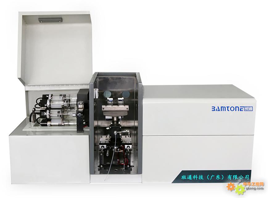

²úÆ·Ãû³Æ£º °àͨ¿Æ¼¼AA»úBamtone/AA-800
ÐÍ ºÅ£º Bamtone/AA-800
²úÆ·¹¦ÄÜ£º
  1. ¼ì²âÁéÃô¶È¸ß£¬¸ÉÈÅÒòËØ½ÏÉÙ£¬Ó¦Ó÷¶Î§¹ã£¬²Ù×÷¼ò±ã£¬¾«ÃÜ׼ȷ¡£
  2. ËĵÆÎ»×ªËþʽµÆ×ù£¨È«×Ô¶¯Çл»£©£¬¿Éͬʱ²åËÄÖ»µÆ£¬
  3. Ô¤ÈȵÆÊýÁ¿¿É×Ô¶¨Ò壬¿ÉËÄÖ§µÆÍ¬Ê±Ô¤ÈÈ£¬Ëõ¶ÌʹÓùý³ÌÖеĵȴýʱ¼ä£¬
  4. Ô¤Áôʯ°×ÔÑùÆ÷Éý¼¶¶Ë¿Ú£¬Âú×ãÉ豸δÀ´¿ÉÄÜÀ©Õ¹¹¦ÄÜ£¬
  5. ²âÊÔ½á¹û¿ÉÓø÷ÖÖ¸ñʽµ¼³ö£¬¿ÉÖ±½ÓÓð칫Èí¼þ´ò¿ª£¬¸ü¼Ó·½±ã¿ì½Ý£¬
  6. Èí¼þ¿ÉÔ¶³Ì¿ØÖÆ£¬³öÏÖÎÊÌâʱ¿ÉÌṩԶ³Ì¼¼ÊõÖ§³Ö£¬Ê¹ÎÊÌâ½â¾ö¸ü¼Ó¼°Ê±¡£
Ó¦Ó÷¶Î§£º
Ó¦ÓÃÓÚ¹¤Òµ¡¢Å©Òµ¡¢Ê¯ÓÍ¡¢»¯¹¤¡¢Ò±½ð¡¢µØÖÊ¡¢ÉúÎҽѧ¡¢Ê³Æ·¡¢²ÄÁÏ¡¢»·¾³±£»¤µÈ¸÷ÐÐÒµ¡£
²úÆ·ÌØµã£º
  1. ²ÉÓõçÄÔ¶ÔÒÇÆ÷½øÐÐÈ«×Ô¶¯¿ØÖƺÍÊý¾Ý´¦Àí£¬µ¥»ðÑæ·¢Ô­×Ó»¯ÏµÍ³¡£
  2. Ô¤ÏÈÓÅ»¯µÄ¹¤×÷Ìõ¼þ£¬×ÔÎüÊÕ¿Û±³¾°
  3. ËÄÖ»µÆµÆ×ù¿É×Ô¶¯×ª»»¼°Î¢µ÷µÆÎ»£»¿É×ÔÓÉÉ趨¹¤×÷µÆ¡¢Ô¤ÈȵƳ̶ȽÚÊ¡ÔªËØµÆ×¼±¸Ê±¼ä¡£
  4. ÏûÏà²îC-TÐ͵¥É«Æ÷£¬½ø¿Ú´óÃæ»ý¹âÕ¤£¨¿ÌÏß1800Ìõ/mm£©
  5. È«·´Éä¹âѧϵͳ£¬È«²¨¶ÎÏûÉ«²î£¬¾Û½¹µãµ÷½ÚºÃÖ®ºó¸ü»»ÈÎÒ»²¨³¤£¬¾Û½¹µã¾ù²»ÔÙ·¢Éú±ä»¯£¬²¨³¤×Ô¶¯É¨Ãè¡¢×Ô¶¯Ñ°·å¡£
  6. ÊÖ¶¯µç×ÓÂö³åµç»°ÇÀµã»ð¼°ÖúÈ¼ÆøÂ©Æø¼à²â¡£¶ÀÌØÉè¼ÆµÄÈ«îÑȼÉÕÆ÷£¬È¼ÉÕÆ½ÎÈ£¬ÈÈÆ½ºâËÙ¶È¿ì
  7. Å䱸µÍÔëÉù¿ÕÆøÑ¹Ëõ»ú£¬¼õÉÙʵÑéÊÒÔëÉùÎÛȾ
¼¼Êõ²ÎÊý£º
  1. µÆÎ»¼°Çл» :°ËµÆÎ»µçÄÔ×Ô¶¯Çл»µ÷½Ú(ÆäÖжþ֧Ϊ¸ßÐÔÄܵÆ)£»
  2. ½¹¾à:270mm £¨ÉÁÒ«²¨³¤:250mm£©£»¡¡
  3. ²¨³¤·¶Î§£º185-900nm£»¡¡
  4. ¹âÕ¤:1800Ìõ/mmÔ­×°½ø¿Ú¼þ£¨±öËÉ£©£»
  5. ¹â¹Ü(ºËÐIJ¿¼þ¹âµç±¶Ôö¹Ü):Ô­×°ÈÕ±¾½ø¿Ú£¨±öËÉ£©£»¡¡
  6. µã»ð·½Ê½:µç×Óǹµã»ð£»¡¡
  7. ²¨³¤¾«È·¶È£ºÈ«²¨¶ÎÓÅÓÚ±0.25nm¡¡ ÓÅÓÚ¹ú±ê£¨¹ú±êΪ±≤0.5nm£©£»¡¡
  8. ²¨³¤Öظ´ÐÔ£º≤0.15nm¡¡ÓÅÓÚ¹ú±ê£¨¹ú±êΪ≤0.3nm£©£»
  9. ·Ö±æÂÊ£º¹âÆ×´ø¿í0.2nmʱ·Ö¿ªÃÌ279.5nmºÍ279.8nmË«Ïß ¹È·åÄÜÁ¿±È<20%.ÓÅÓÚ¹ú±ê£»
  10.  »ùÏßÎȶ¨ÐÔ(Cu)£º ≤0.004A/30min¡¡ÓÅÓÚ¹ú±ê£¨¹ú±êΪ≤0.006A/30min£©£»
  11. ÌØÕ÷Ũ¶È(Cu)£º ≤0.025ug/ml/1% ÓÅÓÚ¹ú±ê (¹ú±êΪ≤0.05ug/ml/1%)£»¡¡
  12.  ¼ì³öÏÞ(Cu)£º≤0.005ug/ml¡¡ÓÅÓÚ¹ú±ê£¨¹ú±êΪ≤0.008ug/ml£©£»
  13. ¾«ÃܶÈRSD(Cu)£º£¼0.5£¥¶Ô ÓÅÓÚ¹ú±ê£¨¹ú±êΪ≤0.008ug/ml£©£»
  14. ¹âÆ×´ø¿í:0.1  0.2¡¢0.4¡¢1.0  2.0nmÎåµµµçÄÔ×Ôµ÷ £¨ÒÇÆ÷ĬÈÏ0.2nm£¬Í¨ÓÃËùÓзÖÎöÔªËØ£©£»¡¡
  15. ÒÇÆ÷²Ù×÷Èí¼þ:¼òÌåÖÐÎÄ¡¢Ó¢ÎÄ (¹¤×÷»·¾³£ºWin XP Win 7  Vista²Ù×÷ϵͳ),Èí¼þ¹¦ÄÜÇ¿´ó£¬ÈËÐÔ»¯µÄÉè¼Æ£¬È÷ÖÎö±äµÃ׼ȷ¿ì½Ý£¬·ÖÎöÊý¾Ý½á¹ûÖ±½Óת»»³ÉexcelÎĵµ£¬·½±ã ±à¼­,³§¼Ò¿ÉÔ¶³Ì¶ÔÒÇÆ÷½øÐÐУÕý£»
  16. Ũ¶È¼ÆË㷽ʽ :±ê×¼ÇúÏß·¨£¨1¡«3´ÎÇúÏߣ©£¬±ê×¼¼ÓÈë·¨£¬Äڲ巨£»Öظ´²âÁ¿´ÎÊý :1¡«20´Î£¬Öظ´²âÁ¿¼ÆËãÆ½¾ùÖµ£¬×Ô¶¯¸ø³ö±ê׼ƫ²îºÍÏà¶Ô±ê׼ƫ²î£»
  17. ½á¹û´òÓ¡ :²ÎÊý´òÓ¡£¬Êý¾Ý½á¹û´òÓ¡£¬Í¼ÐδòÓ¡£¬¿ÉʵÏÖµ¥ÔªËØÓë¶àÔªËØ·ÖÎöµÄ±¨¸æ»ã×ܱ¨¸æ£»
  18. ȼÉÕÆ÷£º100mm½ðÊôîÑȼÉÕÆ÷£¬¿ÕÀäÔ¤»ìºÏÐÍ£»¡¡
  19. ÅçÎíÆ÷£º¸ßЧ²£Á§¡¢È«ËÜ¡¢²»Ðâ¸ÖÎí»¯Æ÷£»¡¡
  20. Îí»¯ÊÒ£ºÄ͸¯Ê´²ÄÁÏÎí»¯ÊÒ£»¡¡
  21. λÖõ÷½Ú£º»ðÑæÈ¼ÉÕÆ÷×î¼Ñ¸ß¶È¼°Ç°ºóλÖÿɵ÷£¬Ò»·ÝÖÓµãÍê³É»ðÑæ/Ç⻯Îï»»×°£»¡¡
  22. ±£»¤¹¦ÄÜ£º¾ßÓжàÖÖ×Ô¶¯°²È«±£»¤¹¦ÄÜ£¬ÒÒÈ²Â©Æø±¨¾¯¡¢¹Ø±Õϵͳ£»¡¡
  23. µÆµçÁ÷:½öÓÃ3mAµÆ¹¤×÷µçÁ÷£¬Ìá¸ß·ÖÎöÎȶ¨ÐÔ£¬Í¬Ê±Ê¹ÔªËصÆÊ¹ÓÃÊÙÃü≥1500¸öСʱ£»¡¡
  24. ʯī¯:»ðÑæ-ʯī¯×Ô¶¯Çл»Ò»Ìå»ú£¨Ñ¡¹º£©£»¡¡
  25. ×Ô¶¯½øÑùÆ÷:±¸ÓÐ×Ô¶¯½øÑùÆ÷µÄÉý¼¶¶Ë¿Ú£¬60¸ö½øÑù±­(Ñ¡¹º)£»¡¡
Ö÷»ú¹æ¸ñ:
  1. µçÔ´£º AC220V/50Hz¡¡¡¡¡¡
  2. ¹¦ÂÊ£º 200VA   ÖØÁ¿£º 100kg
  3. Ìå»ý£º1000mm£¨³¤£©×350mm£¨¿í£©×390mm£¨¸ß£©
  4. ¹¤×÷»·¾³Î¶ȣº10¡«35¡æ ¹¤×÷»·¾³Êª¶È£º≤80%
